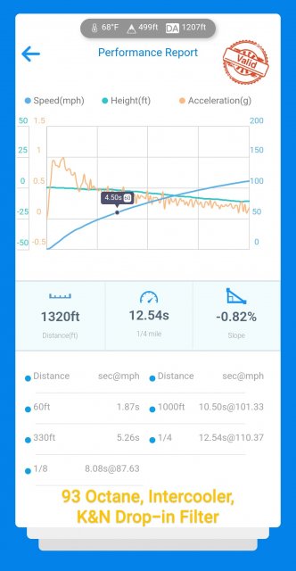

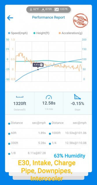

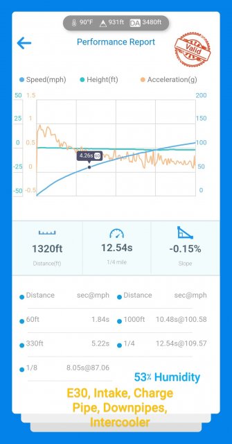

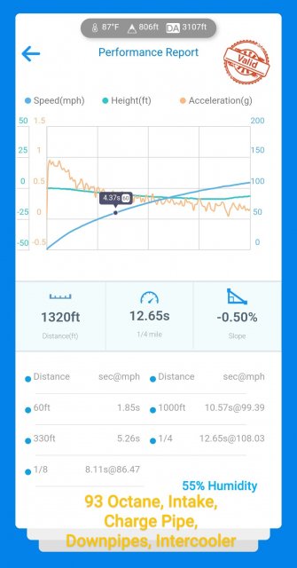

So I have some interesting data from the Dragy that may reinforce the driveline protection theory. I have my 4 quickest valid runs with quite different mods and conditions.
This run is from September, 2021
This one was from 2 days ago before the E30 tune.
This one is from yesterday on E30
This one is from early this morning while the DA and temp was low Screenshot_20220922-063242_dragy~3.jpg
Both tunes are LMS stage 4. It seems like something is preventing it from breaking the 12.5 sec. barrier. I'm not familiar enough with reading PID data to know how to see if it's pulling timing or fuel to reduce torque output but it seems like E30 with boltons should be noticeably quicker than just 93 and an intercooler.
