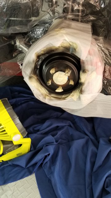

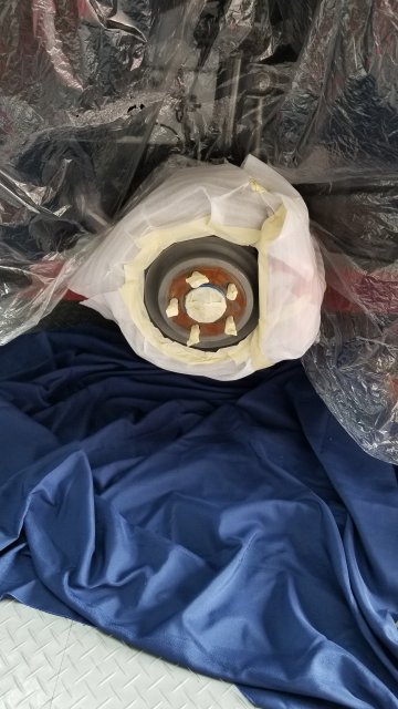

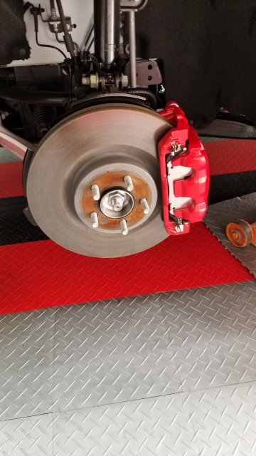

Got to keep those rotors painted and looking good.... especially my new 22-in rims hide very little of the rotor. If it isn't looking good my OCD kicks in and I'm miserable.

It took me about 4 hours to do. The fronts were easier. The back didn't spin. So I painted 60%. Put the wheel back on. Did the other rear. Put that wheel back on. Moved the car forward 3 feet and removed wheels again and finished. It was worth the effort. I am too OCD to let it go.

What type of paint did you use to paint the hubs
Got it sometimes I'm a little slow...lol.. high heat satin black from Home Depot. It took longer to mask than it did to actually paint it. I used "Poor Boys" wheel cleaner to remove any grease and grime. then I sand it with 1,000 grit Emery cloth I believe. Masked with black tape and then plastic and blue painters mask. I've done this for years and it's never given me any grief or ever peeled. I think the prep is the most important. I hope that helps you. It's a little bit of effort but I keep my cars three to four years and if it makes me smile when I look at it it's well worth it. I've been a slave to my cars since I'm 15 years old. They are my only vice beside young pretty women.
