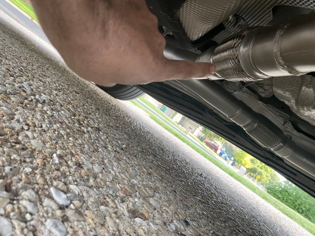

I found the false knock, I think. I had this faint rattle but could never exactly pinpoint. The rattle got way worse over the last week and flex pipes are the culprit. I saw another member had pretty good luck cutting out the stock mesh covered flex pipes and replaced them with some woven flex pipes. Here is a short clip of the rattle.

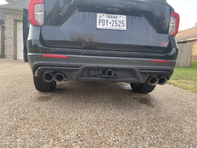

Took the ST up to Kinny’s Muffler Shop, they share a building with the transmission shop.
I cannot believe how amazing the exhaust sounds. It has a commanding bassy sound that is absolutely beautiful. When I dropped the car off it sounded like a I dragging tin cans behind me due to the flex pipes. Now it sounds like a super car, it’s awesome!
When I pulled in they were installing two systems in his and hers Maserati’s so I figured Is in the right spot. The exhaust cost $1100 installed with 3” tips and $1400 with 4” tips and the woven flex pipe.
I don’t think I have ever been so happy with an exhaust system, not mention the insane KR issues from the stock system are gone. I hope to get her to the track this week if it’s not raining but I’m sure it will be raining.
A few people have videos of the same system on YouTube if you search Kinny’s Explorer but videos don’t really capture the full range and feel of the system. Here’s a few pics of the system:

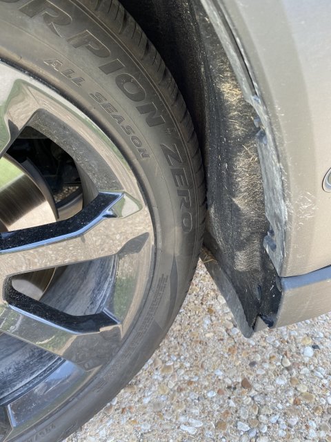

Found the last source of false knock. I hit a pothole a month ago in Michigan in the middle of the night and apparently a couple pins were broken on the fender which was also causing the wheels to run the inner fender well.
