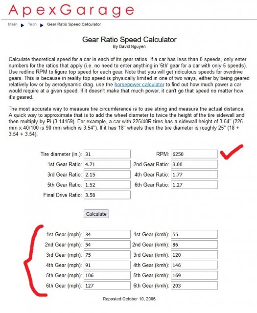

Publications like C&D and R&T used to have detailed road test charts that showed maximum speed in gears. They rarely do them any more so I did it myself.
First 6 gears for stock 20"/21" ST wheels (outside tire diameter is the same) at maximum engine RPM of 6,000 - 6,250 - 6,500:

P.S. Interesting note: 60 mph needs 3rd gear and the quarter mile needs 5th gear

If I understand you correctly, you would like to know the result of each gear's MPH Per 1,000 RPM.
In that case:
1st Gear = 5.5 MPH Per 1,000 RPM
2nd Gear = 8.6 MPH Per 1,000 RPM
3rd Gear = 12.0 MPH Per 1,000 RPM
4th Gear = 14.5 MPH Per 1,000 RPM
5th Gear = 17.0 MPH Per 1,000 RPM
6th Gear = 20.3 MPH Per 1,000 RPM
So your shift from to 1st to 2nd at 18 mph occurs when 1st gear is at 3,270 RPM, at which point 2nd gear would be at 2,090 RPM.
Hope that helps!

Ford Guy was figuring for an 18 mph shift in first gear (which occurs at 3,270).
Going into 2nd gear at that speed (18 mph) would bring him to 2,090 rpm.
That would be a drop of 1,180 rpm.
So, your math is basically correct for what you're trying to compute.
