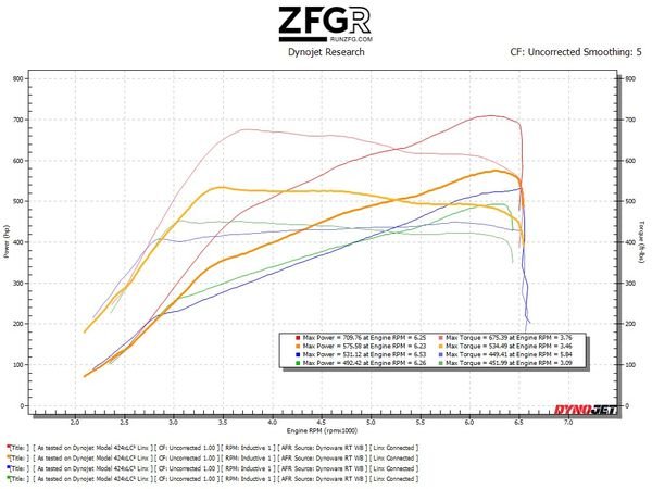

Here's my favorite pic from the 2023 Shootout in Ohio, last track slip and most current dyno sheet. Track and dragy times are all at about 660hp
