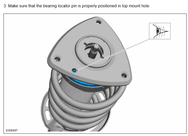

I installed Eibach springs a few weeks back and just rechecked my work to ensure everything is tight. I noticed that the tab on the bearing plate is not 100% lined up with the tab directly below it on the insulator, it's close, but I'm guessing it moved a touch while tightening everything down. How critical is it that these two tabs be lined up exactly?

The Service Manual shows a locator hole in the top of the strut plate and there is a little stub on the wedge that is supposed to fit into that locator hole.
From the "Ford Explorer: Front Suspension - RWD / Disassembly and Assembly - Front Strut and Spring Assembly" section:
Not sure how tight the pin-to-hole fit is but there is likely a little play (guestimating plus/minus 1/16" / 1.5 mm or so).
