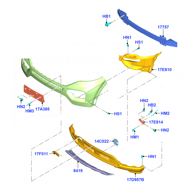

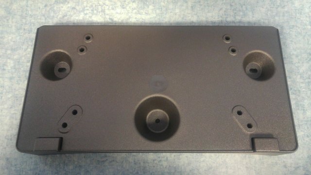

Need some help. Can anyone tell me the Ford part number for the front license plate bracket on the 2020 Explorer ST? Bonus, can you show me how it is attached and by what fasteners? I bought in PA but live in upstate NY. Thanks!

They use rivets to mount the bracket. Be thankful your's didn't come with them mounted. You can probably get a tow hook style mount which should clear the front sensors. You also can't block the lower grill area because that's where the Adaptive Cruise Control sensor is mounted.

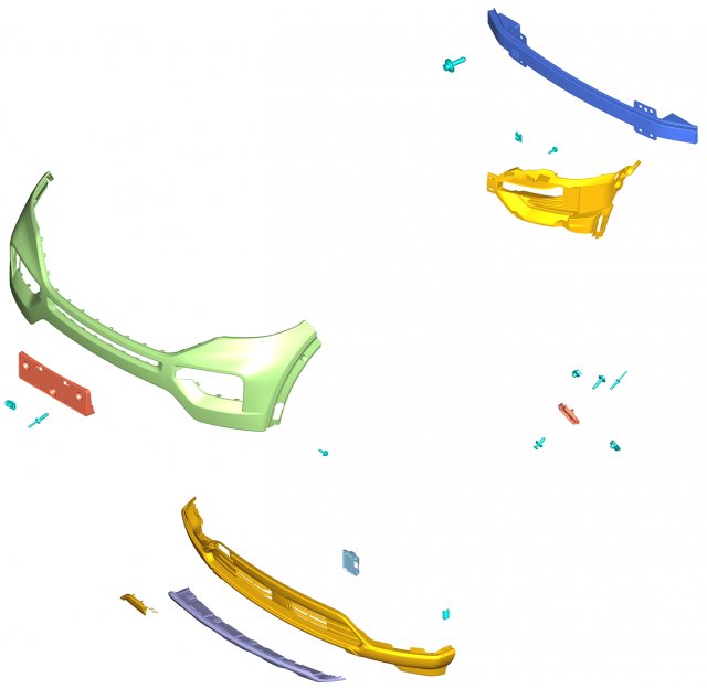

Hope this helps.
Part #: 17A385 https://parts.ford.com/shop/en/us/b...-parts-front/bracket-license-plate-11530943-1
Usage: 05/06/2019, Explorer 2020-, ST Version, Front License Plate Holder Deluxe
Section: Radiator Grille and Front Bumper
  • 14C022 - Bracket - Sensor Mounting
  • 17757 - Bumper Assy - Front
  • 17A385 - Bracket - License Plate
  • 17D957A - Bumper Assy - Front
  • 17D957B - Bumper Assy - Front
  • 17E810 - Cover
  • 17E814 - Reinforcement
  • 17F011 - Cover
  • 8419 - Moulding
  • HB1 - Bolt
  • HB2 - Bolt
  • HM1 - Hardware - Miscellaneous
  • HM2 - Hardware - Miscellaneous
  • HM3 - Hardware - Miscellaneous
  • HN1 - Nut
  • HN2 - Nut
  • HS1 - Screw

I may be overthinking this but I see a line tracing from the bottom hole where the HN2 Nut is traced from the top of the sensor bracket 14C022. I don't have that HN2 nut and I don't want to take the chance of messing with the sensor bracket by drilling the hole and putting in the rivet. Who would have thought a license plate bracket would be such a PITA :) ? Maybe I will just look at the tow hook option but with the snow we get here and it sticks out, I am not too thrilled with that idea.

I would avoid drilling into the bumper at all costs. Even using double sided tape is better than putting holes in the bumper.

3/16 drill through the middle and pull the plastic rivet straight out. Just did mine and ordered plugs to match.
