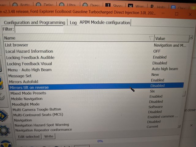

Forscan mirror settings

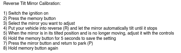

What might help you a bit more is in that same link I sent, at the bottom, there is this blurb to help with the 'calibration' of the reverse tilting mirrors.
**Again, the document has warnings for this so I am not telling you to do this**
Hahahaha yeah thx. I don’t think I’ll really mess with it. Might even end up disabling it since I just utilize 360 top down view mostly anyways.
