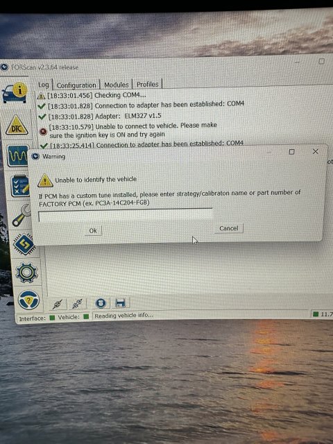

I finally got around to making some changes with forscan but as soon as I connected it to the car and hit connect I got this error message. I’m currently tuned with zfg if that makes a difference on the code I type in? Thanks

you can enter any valid explore software part number to get past this. such as
RB5A-14C204-BTA
that will load the right format to access the ecu.
