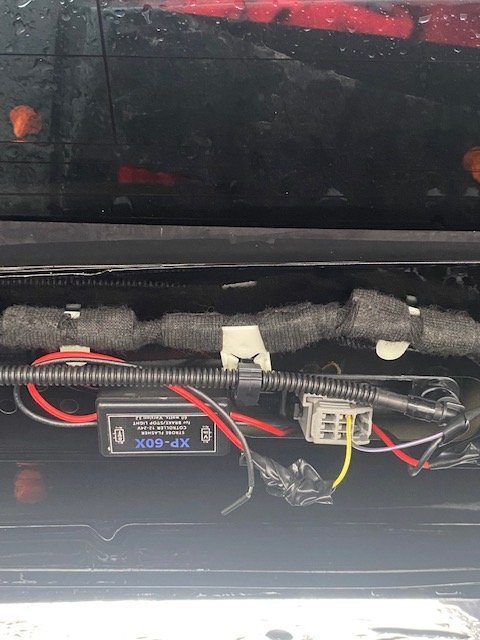

It comes with instructions for install... you do cut factory wires but they give you everything you need. i went cheapo and twisted with electrical tape since they are simple thin wires.
Takes 10-15 minutes in your driveway.
Quick instructions:
Pop the plastic trim piece.. literally just pops off and pulls away.
Factory connector.. the yellow wire is the hot wire and the purple wire is the ground.
Cut the yellow wire..
"OUT" of the flasher box... black ground is unused... red ties in to the connector side yellow.
"IN" of the flaser box.. black ground taps into connector ground... red ties in to the body side yellow.
Mount and wam bam you got a cool and safe third brake light flasher.
quick idea of where I mounted mine... I cleaned it up after this picture but not much haha... it's hidden behind the trim panel and going no where.

The plastic trim piece you noted, is that the interior upper trim panel on the lift gate?
Yes.. once you open the tailgate.. its the piece at the top of the rear windshield... right where the third brake light is mounted. Literally pops right off.
And as always.. disconnect the battery first!
Quick instructions:
Why did you not use the ground?
407
230
Buffalo, NY, USA
not fully versed on things like that so don’t want to answer incorrectly on why it’s not needed. I’m sure there’s others that can chime in with better info but I just followed the instructions it came with and it’s been working ever since. 3+ years and not a single issue
