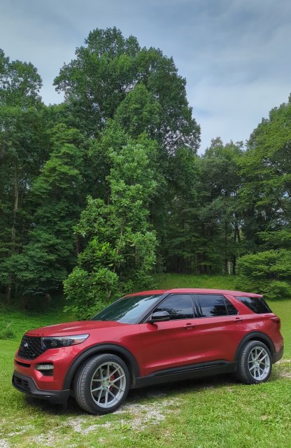

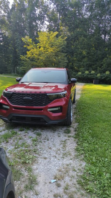

Finally pulled the trigger and bought wheels. I originally picked these out in 21x10.5 ET25 but wanted to be at ET30 so I decided to go with ET42 and 12mm spacers. Needless to say the 12mm spacers didn't work out. So.... Ended up with 21x10.5 ET42 AND still running my 1.25in Bora spacers. Tires are Lionhart 295/40/21.
No rubbing and very aggressive look. I am also lowered on HR springs. Still needs to be a little lower I think to fill the wheel well but overall I'm happy.

Side shot? I have my doubts that there’s no rubbing.

Looks good and the roof rails removed really makes it look even better. Install some graveyard coilovers to lower it more.

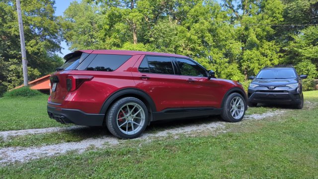

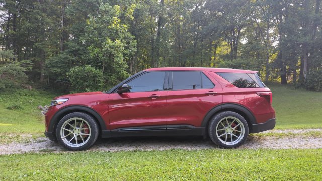

Side shot like the last pic? Or you want a different one? I can confirm there is no rubbing even at full lock both ways. It's close but does not make contact.

Like down the side to show the protrusion.

It's pretty much the same as the stock wheels were on these spacers Snapchat-247380734.jpg

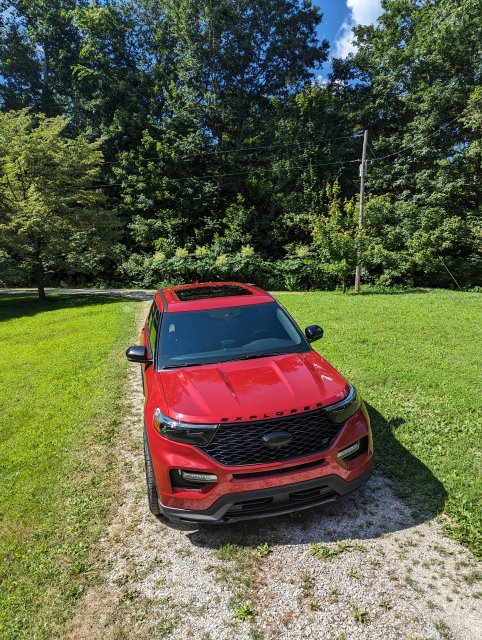

Anything outside of the wheel arch is too much. Just my opinion
Sent from my Pixel 7 using Tapatalk
It is a little wide but it's what I could make do for the time being. To get them to sit flush with smaller spacers I will have to get extended lug bolts.

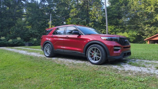

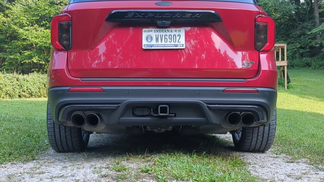

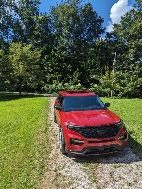

Couple more shots from this morning.

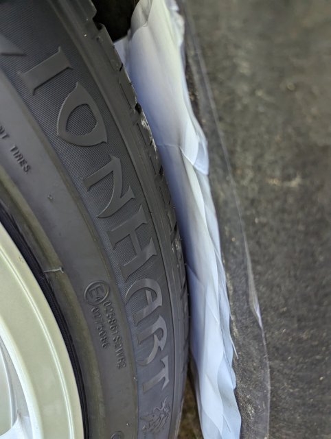

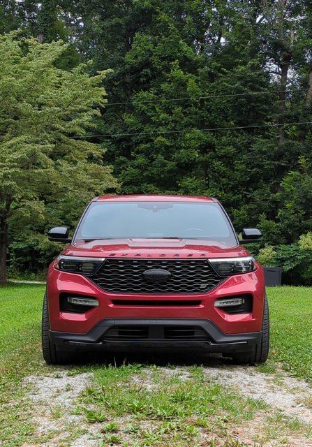

Two pics showing the amount of wheel poke.
