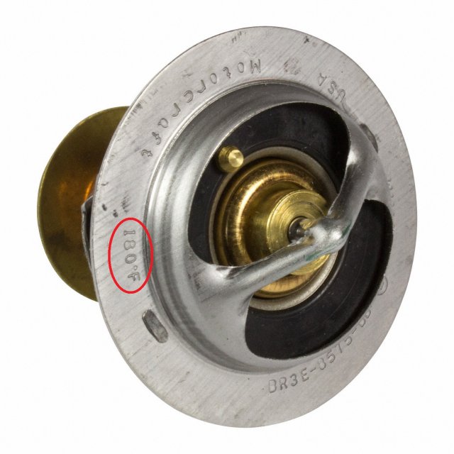

The stock RT1225:
There's lots of info in the thread I created on a 170° version, which I'm guessing you have seen. Those of us in the Cobra world have been using the 170 for years, which is another model that is easily crafted with two Stant thermostats for less than $20. Some reading on it from my Terminator site: http://www.terminator-cobra.com/cooling.htm#170°_Thermostat

Because SPD makes a 180 & 170 option. Apparently the factory thermostat on the ST is 180, so getting the SPD 180 is virtually pointless. So you'd think "hey I should get the 170." Except if you live in a colder climate it may make more sense to keep the factory (180) thermostat.

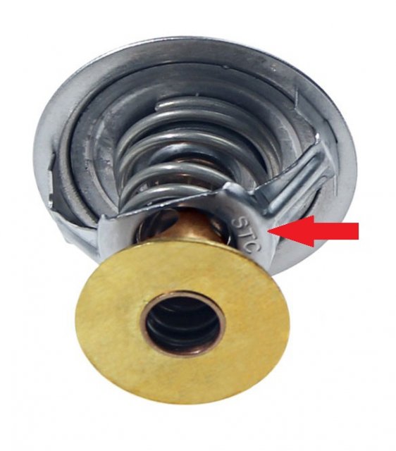

That's looks like a Stant thermostat or an OE Motorcraft, which is made by Stant. If you see "STC" on the bottom, for Stant Thermostat Corporation, that will tell you. A certain on-line vendor that sells the 170° for a ridiculous price uses them as well. It's why I pointed out how easy it was to make them a low-cost DIY project rather than pay three times as much for the same thing.
