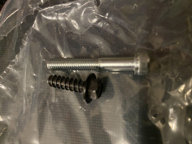

Does anyone know the type(zic, coated steel), size & pitch of the stock bolts that hold the factory blow off valve on? A friend gave me a Boomba adapter and the bolts that came with it have threads that are wayyyy different than the stock ones. I want to go to the hardware store to get replacement bolts that are the same thread pitch but longer. Sorry for the potato quality picture.
(black) stock bolts are short.
(silver) boomba bolts are nearly twice as long & have a much finer thread pitch.

I believe its a 1.75 pitch m7. You won't find it in a home depot or lowes. Maybe fastenall....

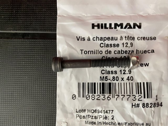

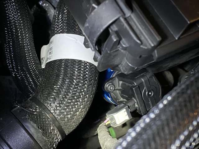

Ask and ye shall recieve... did my best. I went to a Fleet Farm near me and found some M5-.80 x 40mm bolts (hex head,I used an allen key to tighten them). They tightened down really well, and I was careful to not over-tighten. I didn't have to bore out the existing holes either. :)
