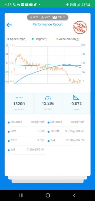

You can see around 1200M I hit the brakes. On crappy Detroit roads, spun until 3rd gear. Easily these are 1.7x cars on any NHRA strip. Honestly, I want to start a 60-100 thread. If we can see compare those acceleration times, I think those are more opportunistic for the daily driver. Screenshot_20220227-161559_dragy.jpg
