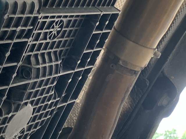

Got under it today and snugged up everything. The midpipes had moved quite a ways off the downpipes. Vibration sounds a lot better, but is still there and quite annoying. At this point I am convinced that it is not a cat, since I partially fixed it. Need to get back under there and check my connections, the new higher-pitched sound almost sounds like 2 sections of the exhaust pinging together inside the clamp.
There is very little clearance between my rear diff cover and my Thermal 3". I'm suspecting that during hard acceleration, they may me colliding and slowly bumping the exhaust back off the downpipes.
Should I leave a little space between the pipes inside the band clamp to rule out 2 pipes colliding inside the clamp during thermal expansion?
Still going to take it to Ford... Could still be a loose heatshield around the downpipes, which I'm unable to get to and inspect.

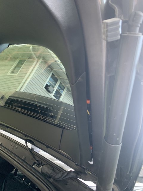

Been driving myself crazy with this. Turns out I've been attacking two separate issues the whole time. I fixed the primary annoying sound coming from the exhaust by re-snugging everything up. What sounded like a heatshield rattle persisted, and I spent more time under the truck than I care to admit. Finally found a loose panel on the liftgate... the panel was never fully assembled and there is a piece of metal or plastic floating around in it.
I was able to push those tabs in, but I'm taking it to the dealer to fish out whatever is rattling around back there.
