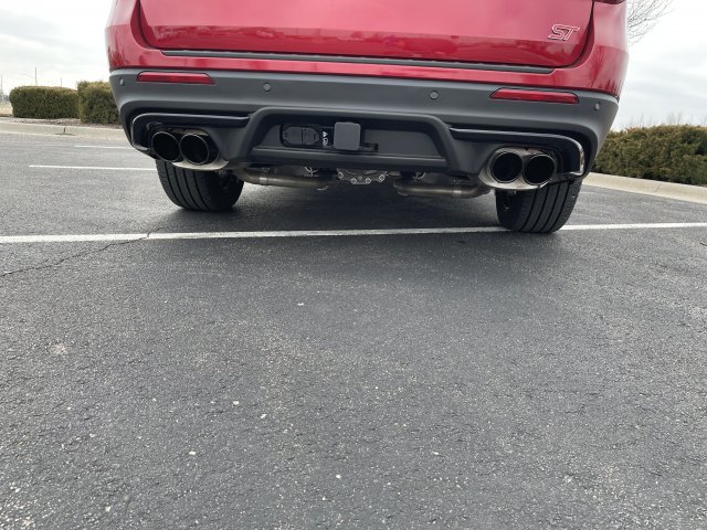

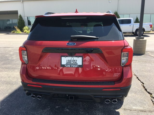

I have had the OEM, Borla S-Type, Magnaflow and now Thermal R&D. Borla S-Type is a partial system that leave you with the crappy OEM midpipes and 2.25 inch exhaust all the way. Magnaflow has a drone around 2000 rpm and is a lower grade stainless steel that rusts easier. It is 2.5 inch full system and I do love the black chrome exhaust tips. Thermal is a 2.5 inch full system of better quality stainless steel with no drone but still sounds nice when you punch it. I did not like the Thermal exhaust tips as they look short and incomplete from certian angles. I replaced the Thermal tips with Hot Rod Scott's (Ontario) custom black and carbon fiber 4 inch quad tips which fit tighter to the bumber like the Borla S-Type. I went with a old U- clamp for the tips as the Thermal exhaust tip clamp kept slipping off.
