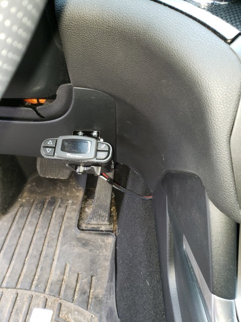

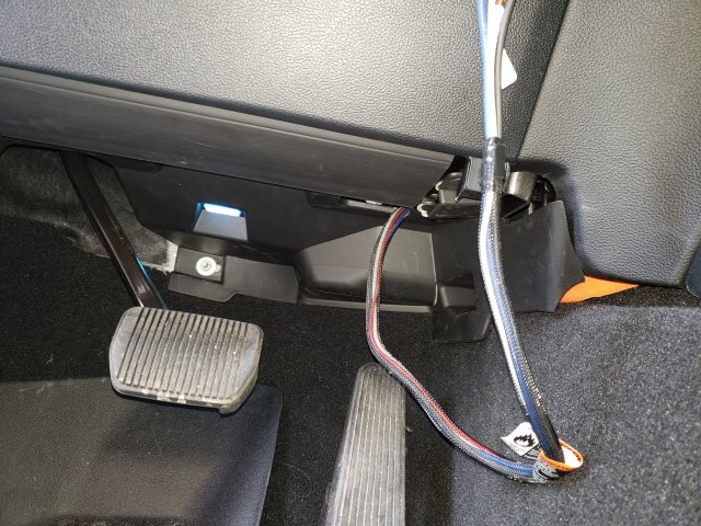

Guys, I'll take a pic, but I didn't watch. When I picked the car up I handed my sales guy the harness. By the time the paperwork was done, it was installed and hung out of the tunnel about shin high. I mounted the unit above my right leg. I'll take a pic tomorrow.

Here's 2 pics. I pulled the wire down so you can see how much slack there is. I tried, but could not feel the connector plug.
