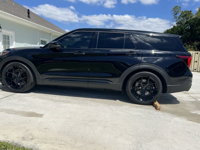

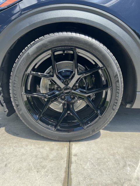

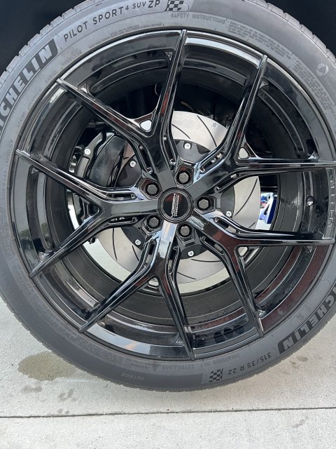

Eibach, 22” Vossen HF F
Ldstang50
100
148
FL
22x10.5 +32
315/35 Michelin PS4 SUV ZP
Superforged BBK 405mm front 385mm rear. Both 6-pot calipers. With the 22” wheels, the brakes still look small

Very nice!

Crazy that that big of an BBK looks small. Looking good though!

That’s one of the reasons I dropped to a 21…to tuck the wheel around the brakes a little better.

Got some pics of the front wheels? Curious to see if it makes a huge difference looks wise for the brakes.

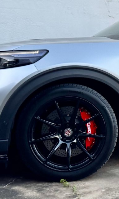

The guy that makes a bracket to use the 15.5" GT350 calipers and rotors also makes one to use the massive 16.5"/420mm GT500 rotors and calipers. Those are the biggest I know of or seen for the 2020+ explorers. Houston speed freaks did an install of the 500 brackets, calipers and rotors on his YouTube channel.

The GT500 ones pretty much fill out most of the wheel too.
