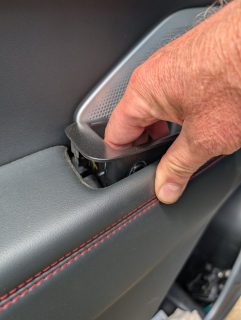

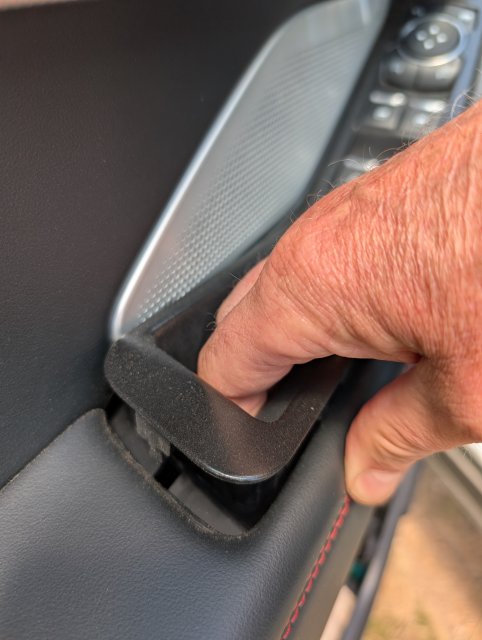

Yesterday I went to close the door on my 2025 ST and the grab handle built into the arm rest pulled out from the rest. I have an appointment at my dealer tomorrow morning for something else and will see what it will take for them to fix this. It would be very easy to snap the plastic off so I'm being cautious in the interim. Anyone else encounter this situation? PXL_20250625_172827161.jpg PXL_20250625_172832906.jpg

They just snap into place. Push it back down.

I pushed it back down but it doesn't seem to want to "snap" and it just comes right back up. Thanks for the suggestion though.

Looks like a trim holder fastener. If it doesn’t push back in you might have to replace it.

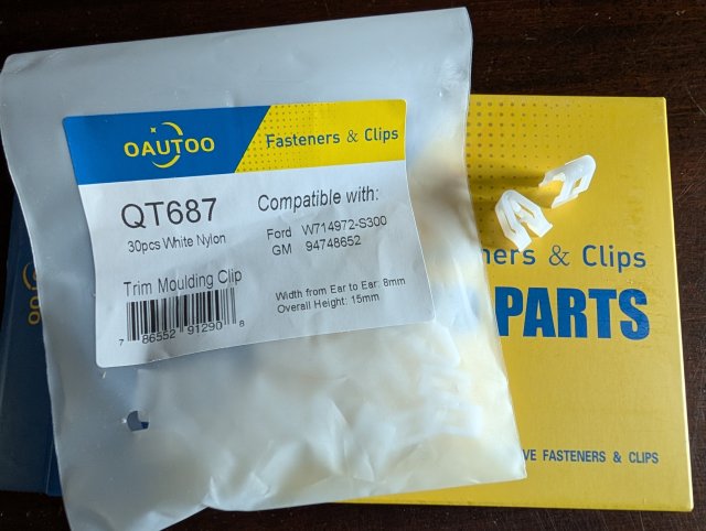

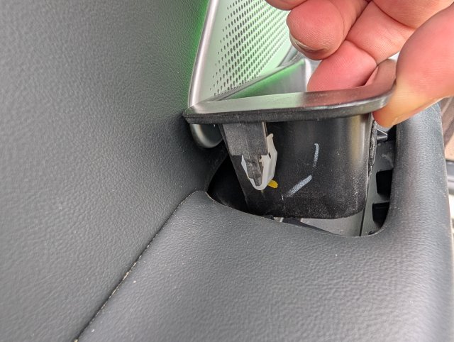

UPDATE: After getting over my shock at the idiotic response from my dealership I just went online and found others who've had the same problem. Then I went to YouTube and watched some dudes take apart the door panel and trim so I could see what the parts looked like. Next, checking a Ford parts website I found that these clips, W714972-S300Body D-Pillar Trim Panel Clip, which cost $1.97 for four of them are what's needed to secure that handle in place. On Amazon I bought these aftermarkets, 30 for $9.99 and they delivered them in 24 hours. It took precisely 5 seconds to install it and now the handle is secure. I'm tempted to take a couple of them to that service advisor and educate him so maybe he could actually help another Explorer owner in the future instead of blowing them off with some B.S.
