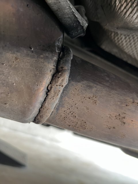

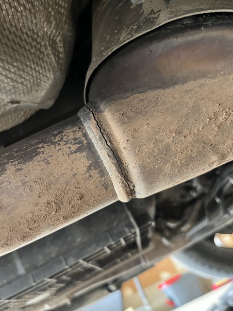

Just bought my 2020 ST about 3 weeks ago. It has 41k miles so just the 60k powertrain warranty left. I bought from a non-franchise dealer, and before purchasing I brought it to a Ford dealer to get it Pre-Purchase Inspected. They did the inspection no problem and only found a couple minor things. I’ve now realized I have the flex pipe rattle pretty bad. Upon looking closer, I noticed that the welds of the downpipes are cracked from rattling (see photos).
A couple dealerships said this is not warrantied, and the dealer who performed the PPI is saying they usually don’t do inspections for other dealers’ vehicles and that I cannot be reimbursed for them missing this (and charging me $230).
Is it correct that these wouldn’t be covered through warranty?

No, that is the catalytic converter pipe--not what we are calling the midpipe with the flex sections. There is a recall for the catalytic converter pipe. If I'm not mistaken, it would be covered under recall no matter what your mileage is. I had it replaced at 55k miles under recall. Just head on over to a Ford dealer. BTW, mine cracked in the same spot.
For the midpipes issues, see:
https://static.nhtsa.gov/odi/tsbs/2021/MC-10204044-0001.pdf
The emission recall involving the LH catalytic converter pipe is 21E11, if you want to look that up.

Thanks so much, that’s just what I needed. Got an appt scheduled for early next week. Hoping they replace both

Let us know what happens. If the downpipes are cracked, they replace those. If the the flex sections have failed, they'll likely replace those. If they just rattle, probably nothing will be done.

The bulletin is only showing LH cat, but you got both replaced through the same recall? Struggling speaking with service director since the 21E11 bulletin only shows the right hand cat being replaced for “police” versions of the 3.0.
The bulletin they’re printing out looks different than the one on the NHTSA website and is saying “supplement #2” in red all over, leading me to believe this one trumped the initial one.

Cats are emission components and will always be covered for 8 years or 80k miles. That’s federal law.

Correct. After arguing with the service director for about 30 min, ended up throwing that out there about the 80k mile. Only left cat covered through ford recall, but they will do the right one through the federal recall.
