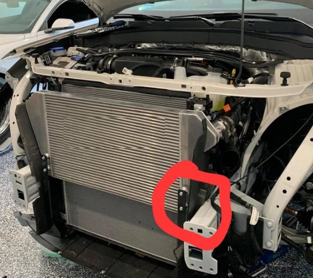

@CVF-Jason any word on compatibility with the PHEV model? I think if the brackets would mount/rest on the circled parts it should work. (image of normal ST, not the PHEV version. The PHEV has 2 extra coolers that would go beneath the intercooler.
No word yet, but I did ask one of our guys again to try to get a definitive answer. If it makes a difference if any other brands do fit ours will as well.
Unfortunately, none of the other brands would be a direct fit due to the extra coolers getting in the way of the supports. I'm not sure how that's done on the CVFab intercoolers.
If the intercooler would get supported like i said in the previous post, on the 'rails'? (not sure if that's the correct term!?) it wouldn't be a problem.
Gotcha! I will ask to be certain, but if other intercoolers are seeing their brackets hit the extra pieces then I would assume ours would as well.
