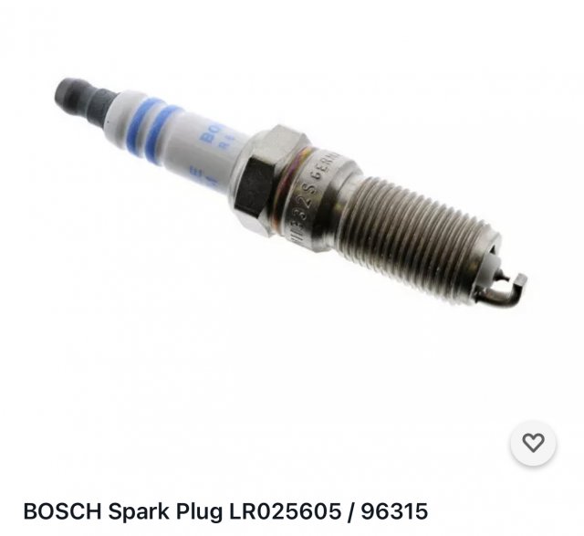

I’ve tried a few different colder plugs. These by far idle the smoothest. C03E0081-4AD7-4EC3-AA5F-E50FD0ECB0A9.jpeg

don't like NGK? ill check them out
5,770
6,980
Nope. The 6510’s had a noticeable hiccup at idle. 2 different sets.

okay ill order the bosch tonight. i got a tune for the ST and i want to optoimise the tune

what did you gap them at
5,770
6,980
.028 but that’s a discussion for you and your tuner.
