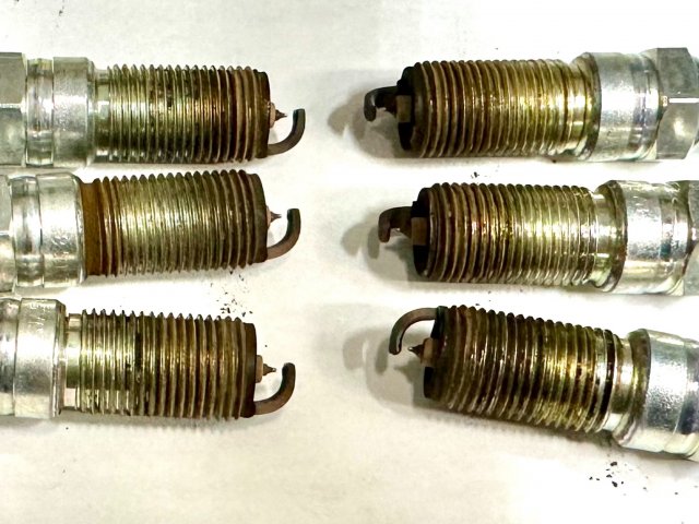

Hey all, I noticed recently that I was having some vibration at idle. I decided to pull the plugs to take a look, driver side came out fine, but passenger side were pretty loose, looser than i would have liked and the threads seem to have carbon or oil coking. Needless to say I changed them for some bosch 1 step colder while I was at it. 20230110_185648.jpg

Mileage?

Did the vibration at idle go away with the Bosch plugs installed?
I always thought that issue was fuel quality?
The issue went away completely, idle feels better

What Bosch plug model did u go with?
Thanks
The rears can be alittle tricky, make sure you have various lengths of extensions and a few swivel adapters
Oh yeah, I heard the passenger side was a nightmare to work on.
I've been getting my use out of the factory ones.
Been running an E50 tune and so far no issues with stock plugs.
With the right equipment it isn't as bad as ppl make it out to be, should be a nice 2 hour install from start to finish

At least you went with the right Bosch plug…too many people wasting money on NGK 6510’s for a colder plug and these 3.0’s hate them.

Just changed mine today. These are after 60k miles. Left side with a little more burnt appearance but nothing too bad.
Stock was Motorcraft SP 578. Now replacement listed as SP 594. Both iridium. The 594 were all pre-gaped.
ive always used bosch, they make tons of aerospace and oem components. ive run them in 3 of my past 4 vehicles and have never had a problem.
What’s that gap? Looks rather large in the pic.
Didn't measure the old ones. Spec says they should be 0.028-0.030 in. All the new Motorcraft SP 594 measured in that range
