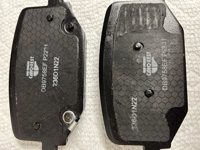

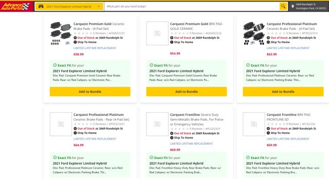

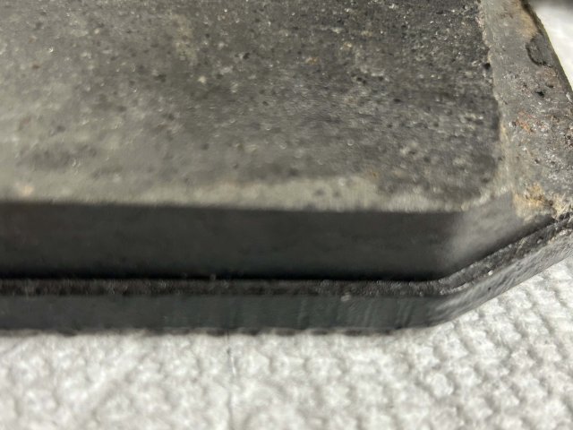

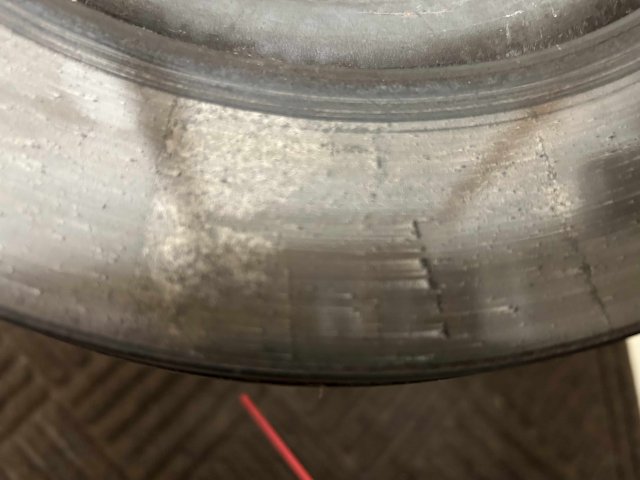

I have a question other than red is there a size difference. I have a 2021 Limited AWD Hybrid with 17000 miles which the dealer installed ceramic pads on @ 13000 to try and fix a problem related to bolt fracture auto packing brake where the pads seized on rotors after washing truck....after a few weeks a loud Grunting noise would be heard everytime the brakes were released. After 5 visits to the dealer I Paid to Have OEM rotors and Pads installed @ $578 The brakes are quite once again. I kept the old parts and found a few things which I'm trying understand. I tried looking up these pads online, but no luck. Finally went to Advaned Auto / Carquest. He said these are wrong pads, they are for Red Calipers, He also said they would have to had forced on to fit, which there are chaffing marks on both sets. Next he look at the rotors and said they're been compressed where the outlines are. Thought the parking brake sensor might the blame. I agree if the wrong pads were installed...
I'm guessing the pads are thicker or the caliper is wider and question using ceramic on stock rotors. This vehicle has 17000 miles last 3000 with ceramic pads.
appreciate the help

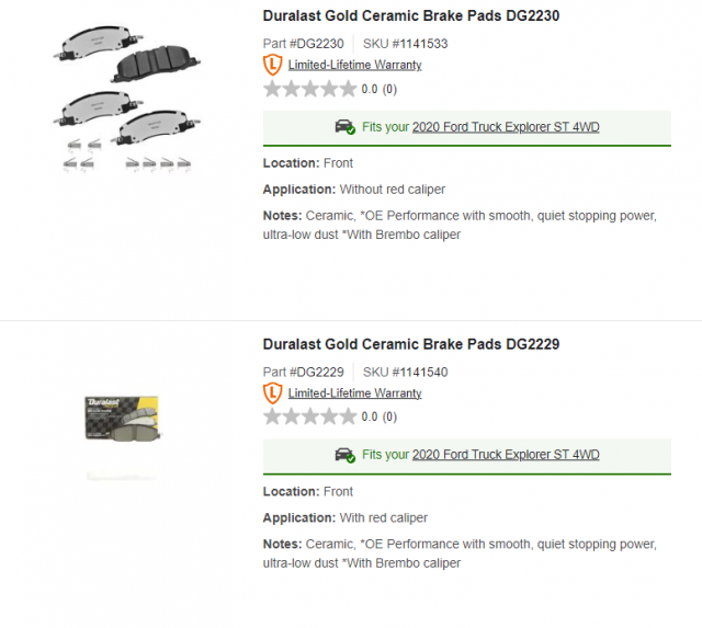

On the Advanced Auto Website, the Explorer pad part numbers ending with 2331 are for Red Calipers, part numbers ending 2332 are for without Red Calipers.
Here is a link with dimensions for those pads (With Red).
https://racingbrake.com/pd2231-391/
Hope this helps

Yes it does....18mm vers 17.6mm OEM .4 x 2 = .8 almost 1mm I don't know if that's a problem but looking at the pads I guessing it is. Thanks again
