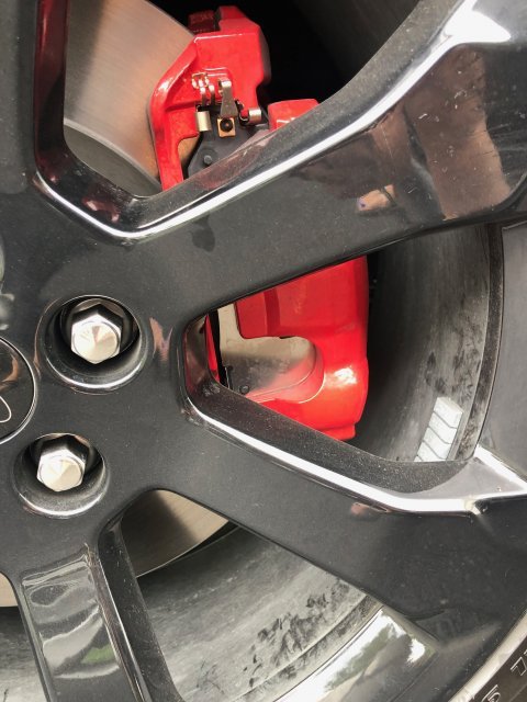

Cool…tons of peoples make noise. Are your front pad backing plates silver or black?

They are silver of course.

Well…the Performance Pack pads have black backing plates. That was the easy way to tell if the dealer installed them in the early days when the cars shipped with the pads in a box and the dealership has to install them.

That's interesting. Ford lists 3 front brake pads for the ST, standard, police high series and performance. Standard are the cheapest in price and performance are the most expensive ones. As far as i can tell the standard and police have black shims and the performance have the silver shim. Is Ford saying that the police high series are actually the performance pack pads? I'm going to put a call in to my Ford parts rep tomorrow and find out more.

This is the Street Pack pads…silver backer.
This is Performance Pack pads. Not a great pic but it’s from someone who bought those pads and had them installed. You can clearly tell they have a black backer.
I guess technically they’re all black, the silver part is a stainless shim that’s used on the Street Pack pads.
