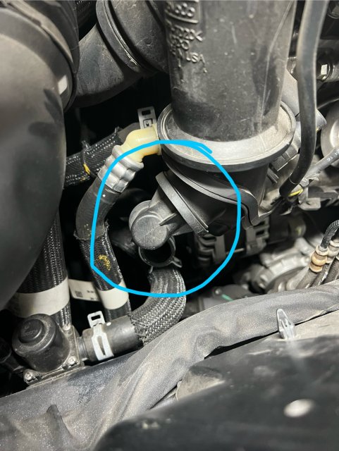

Second question. What brought all of this on is driving home tonight, the ST sounded like it had a BOV. I could hear the psst when I got off throttle in certain situations. Uh-oh, that's not normal. I found a hose disconnected. I originally thought it was the plumb back from the BPV/diverter -- however, after watching intall videos for the TurboSmart, it looks like that is located on the front of the engine, under the airbox. The hose I found disconnected is over on the driver side, on the intake for the turbo. Anyone know what it's for? I've included a picture with the item in question circled. You can just make out the disconnected hose below it.
