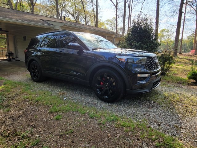

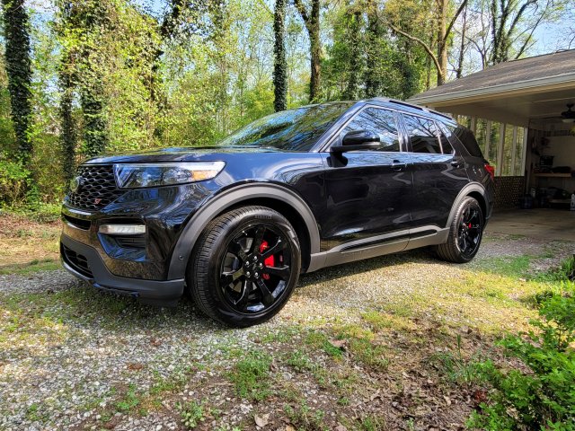

Just got the borla s type, h&r springs, and steeda sway bar installed by local ford dealership. The sales rep screwed up and didn't order the polished black chrome tips, needless to say I was a little angry buy he ordered the new one and will swap it out when it comes in. This exhaust sounds amazing, it doesn't sound like a 4 cylinder camry anymore. The springs and the sway bar make the car handle so much better and the stance looks great. I was concerned about them getting the alignment right but it turned out perfect. The exhaust does rattle and makes some crazy sounds but realized it's coming from the heat shield bolt touching the muffler on the passenger side. I'll get them to cut off the excess bolt touching the muffler. I'm waiting for the Whipple intercooler and palm beach tune to arrive now.
