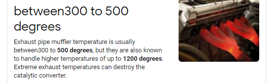

I very rarely hear this noise on mine but can definitely see how close the screw is to hitting. Do you know what temperature (to be extra safe) the stopper would need to be rated at?
I'm no expert but I read they can get as hot as ~500'F. The cheapest trick is to cut them.
