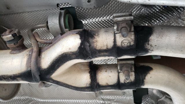

Black staining on exhaust pipe at downpipe and Y-pipe connections.
38
Oregon City, OR, USA

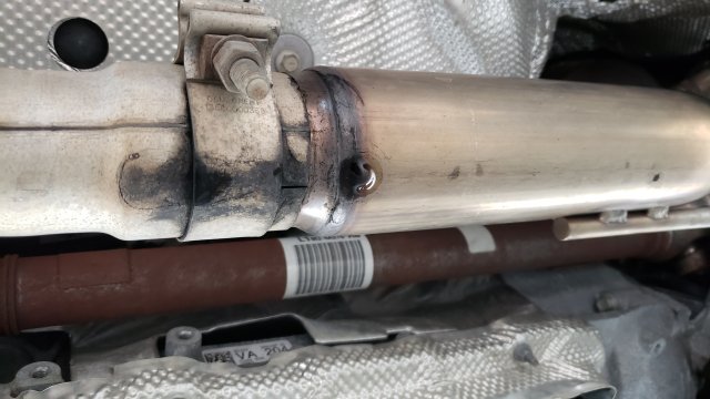

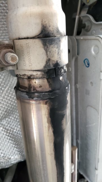

I started noticing black staining on my driveway. I found it's caused by moisture carrying black soot out of the joints at the downpipe and Y-pipe connections. I also see it coming out the drain holes in the mufflers(not pictured). I do have a tune. Any ideas what is causing moisture to do this?
5,627
6,801
Every exhaust does this…just most of them are sealed up so it doesn’t leak out that bad. Your clamps either aren’t tight enough or just suck.
