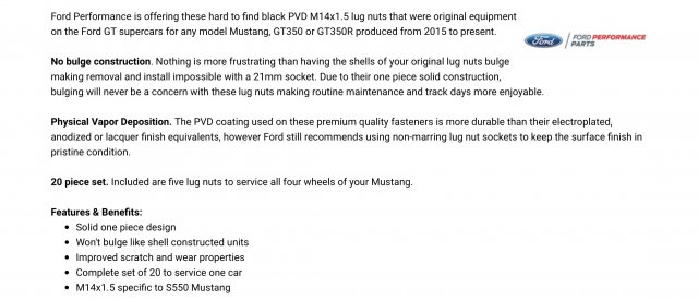

From the Ford Performance description, they are one-piece with a PVD coating…?
Thought about these briefly, especially since the hex is the same, but never bothered.
Steeda has them for around $150 which isn’t too unreasonable.

Ahhh... thank you. I assumed and badly I might add, that these were just Ford's typical black lug nuts. I glanced briefly at the pic and it looks like a capped nut. I didn't read any further.
