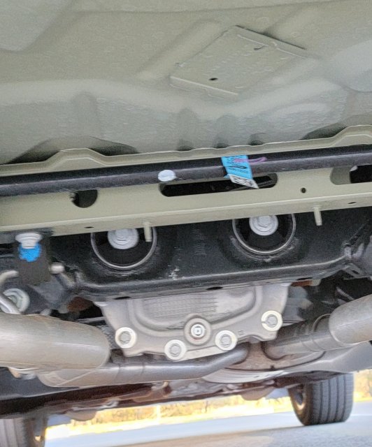

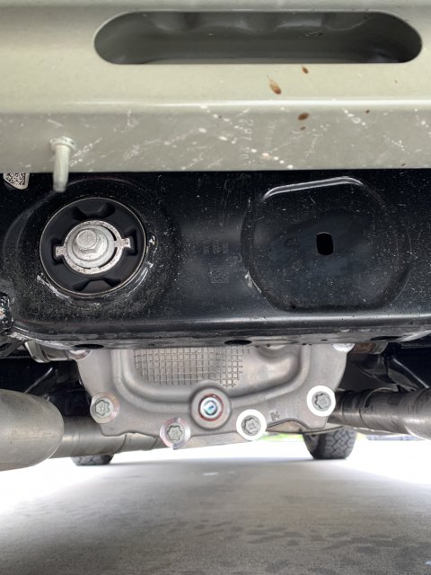

Update: got truck back today & all is well. The main bolt sheered off and damaged pumpkin housing cover, left rear axle halfshaft & rear diff. All replaced under warranty ($3-4k) but Ford’s best guess as to the cause was a potentially loose main housing bolt that weakened over time & sheered due to high torque. Lucky for me, the dealer did not realize (or otherwise care to mention) that I’ve been tuned since month 1 of ownership.
****Everyone should go under the rear differential cover and check to see if they have one bolt or two. If you look at the picture there is a place for two (including threads on the other side) but Ford HQ confirmed only 1 utilized for some dumb reason. I’m not really buying it especially given the number of parts some of us have that others don’t B292158F-D57A-41C4-B0FD-5C816F814C83.jpeg A4BD356E-3ABE-43ED-B0D9-5D8B653B2C2E.jpeg

If we look at this from an engineering perspective...stop thinking Ford did this on purpose to save a buck so they could possibly be out thousands of $ for warranty claims. So, with that in mind, in both the double and single isolators, looking at my vehicle, this seems to be designed to provide some support for the rear differential twisting. My first thought is it makes sense to have two different mounting points to supply the necessary restriction of "twist" under loading and unloading of the driveline. If Ford moved to a single mounting point there must have been some thought in the engineering department that the amount of torque was not enough to justify dual isolators. Looking at the single mount, it's clear that they've also included a more significant mount. In any case, I'm of a mind to suggest as @rjacobs has suggested that the actual problem that @blaster9 experienced is likely not related to that mount, but something else entirely which resulted in the bolt being sheared.
I would have agreed with your assessment if the bolt sheering was limited to the boat/reverse/stop issue but unfortunately, it's not. After having everything replaced under warranty less than 3 weeks ago, the rear end started clunking again when braking at low speeds. Nothing has happened in the past 2.5 weeks other than normal DD (a couple hundred/week) and the occasional gas mash. I let the noise continue for 2-3 more days and then went under to check things out and found the exact same issue (albeit earlier in the implosion process). Grease was flung all over the exhaust again and under body area. It hadnt reached the point where the truck sounded like a bike with index cards in the spoke yet but I know it was obviously well on its way. With a non-refundable family trip to the mountains coming up this wknd, I made a decision to just trade it instead of being "repaired" with another bolt simply to implode somewhere with no cell service. I'm sure I could have kept bringing it back for new rear ends every couple weeks until lemon law came into play, but the fact that i was re-flashing my tune in and out before dealer visits would probably have raised their antennas, voided my warranty, and left me with a huge bill for a temp fix and a filthy carfax.
Moral of the story: if you have a 1-bolt rear end, beware that when you tune, you're probably going to sheer that bolt in half sooner or later. And that guy on FB had a stock ST so it can obviously happen to the un-tuned as well. Not trying to scare everyone but just informing you all to be cautious before dropping a ton of $$ into your ST. I was about to order that $600 CAI when I decided to go under and check. To that end, I really hope UNBROKEN has 2 bolts!

2 bolts on this 2020. Maybe for 2021 they removed the second bolt along with the BOV (kidding) 20211027_171646_resized.jpg

****Everyone should go under the rear differential cover and check to see if they have one bolt or two. If you look at the picture there is a place for two (including threads on the other side) but Ford HQ confirmed only 1 utilized for some dumb reason. I’m not really buying it especially given the number of parts some of us have that others don’t View attachment 6716 View attachment 6717
Thanks for the information! My question concerns the preventative measure of adding the missing bolt and washer you refer to : Bolt And Washer Assembly - Hex.Head - Ford (-W720701-S439). Is it possible to purchase and add it, or are their other parts to obtain? If all that Ford did was omit the Bolt And Washer Assembly, and the threads are in place to receive it, can it just be that simple to crawl underneath and torque it In??
Thanks !
1,464
712
#20
Thanks !
You can't do that. It's missing the entire differential mount that the bolt is supposed to insert into. No way to add that without some serious fabrication. Just compare the pics of the one bolt subframe vs. the two bolt and you'll see what I mean.
