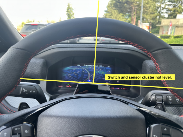

New ST. The module behind the steering wheel, which houses the turn signal, wiper switch, and centered blue cruise module, is not centered. It's leaning to the right about 15 degrees and is an eyesore. Can this be adjusted? It feels like a quality control issue to me. I don't know who would want the ever.
See pic.

Take that to the dealership. I just looked at mine, and it's square.

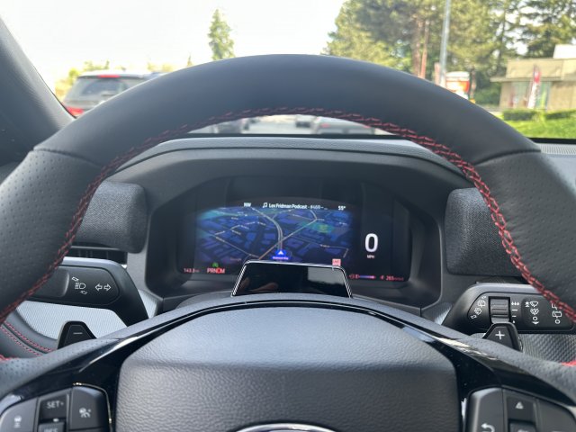

FIXED! Lift the blue cruise cover off the steering column. Align center and replace the cover. Done & Done, all leveled now!

Damn, mine is off too.
I’ll try to pull the cover and see if that works.

The ST experience vehicle we used had the alignment of the blue cruise module crooked.

Huh, I never noticed this misalignment until I read your post and looked at mine today while driving and it not level by maybe 5-6°. I'll ask the dealer to see if they can fix it next time I'm in but I'm sure they'll first try to tell me it's normal or deny it's not level so I'll bring a level to prove it.
