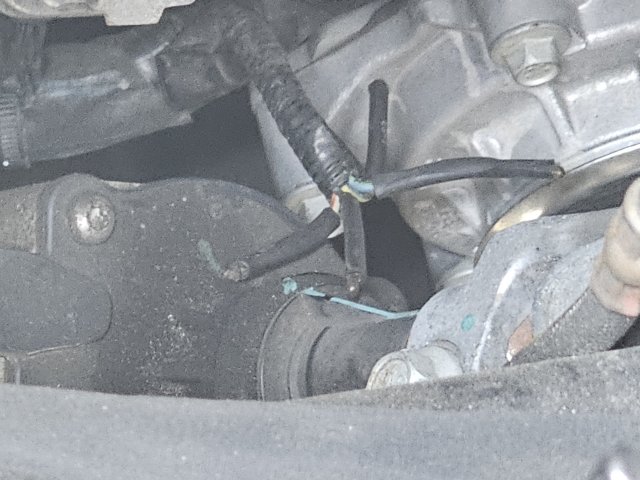

Update: adding to the fun. Now that it's daylight, I am inspecting things. There is a "cut" harness right next to the driver's axle that they replaced. I don't recall seeing this before. There are 4 wires that are cut right next to the newly replaced and. Unsure if this is new... Getting underneath to see if I can find the other end... But this seems too coincidental.
its raining where i am otherwise i would go look under mine for reference. That does look a bit odd tho....... hard to tell in the picture but it does look like someone put E-tape or heat shrink over them. If it is dry later, ill go look at mine for you

Upon further inspection... The wires do have heat shrink on them and a blob of something on the ends. Possibly not new but no idea what this would be or why it is like this. Makes sense to me though that if one of those are contacting metal and there is voltage there, that equals bad things.
Battery is still dead so I can't start it to drive up on my ramps to look at this more.

The cut wires are old. No voltage to them. No idea what they may have been for. They are part of the alternator harness. Regardless, I've re heat shrinked them covering the ends and moved them away from any metal.

Have you ever had the FADA replaced with a non-FADA intermediate shaft? Could be why the harness was cut. I would think if you had a FADA and the harness was cut, it would trigger a code though.

FADA? I bought this used 2 years ago. Certified pre-owned from Ford. Never been any codes or issues.
