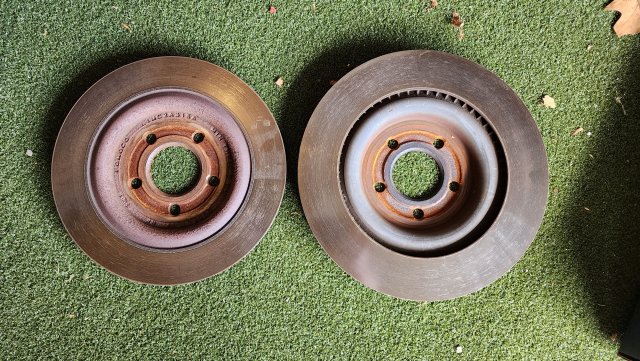

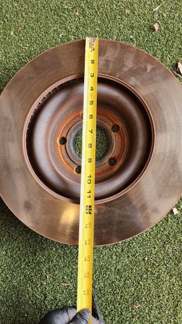

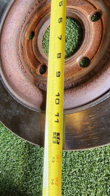

I just finished this swap. All that is needed is calipers with brackets, rotors, and backing plates. (You could probably get away with not swapping the backing plates if you couldn't find them). All lines fit, as well as the parking brake actuator motors.
There is about a ¾" difference in rotor diameter between the Base and Street Pack front rotors. Amd a whopping 1¼" difference in the rear, in addition to them being a vented rotor vs the solid base rotor.
Front rotors
Rear rotors
