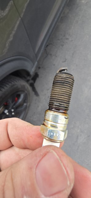

I dont expect to get much from this post considering the lack of information Ive found on this particular issue, but figured id ask anyways. I have an issue of cylinder 5 puddling oil on top of the cylinder on cold start after a drive cycle. I found this while changing the spark plugs trying to search for the issue and using a boroscope. I took it to the dealer and they confirmed the issue, allegedly found oil in the spark plug well (which i did not find when I originally found the issue) and decided to do a valve cover gasket. After picking it up it continued to have the same issue, no change at all. So either the job was botched, which i find to be unlikely, or it has a bad valve seal. Has anyone experienced any issues like this before?

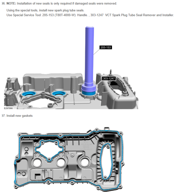

Was the tube seal replaced?
