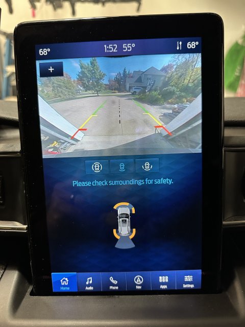

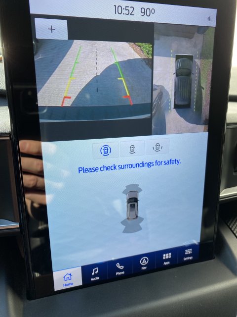

I’ve got a 2020 ST and when in reverse I can only see about 6-7’ behind the car. I come close to hitting people and misc things all the time unless I look back the old fashioned way. Is this view typical?

In these photos the driveway dips down behind me so you can see a bit more than the normal 6-7’. Could you share a photo of yours if it’s a 2020? I haven’t been able to find any online because every search returns the blue screen results.

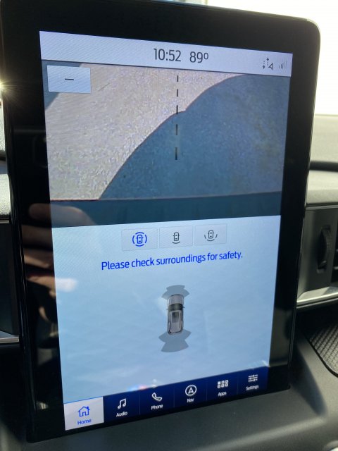

Seems like your rear camera doesn't have wide angle or isn't aimed right.
Here's my 2020 sitting in my garage and also with zoom activated. 730780D8-1220-480A-961E-8079669FAE61.jpeg 68956916-E253-46C2-B724-F9E5ECF0855F.jpeg

That’s crazy! That’s how I imagine it should be and thank you for sharing!
