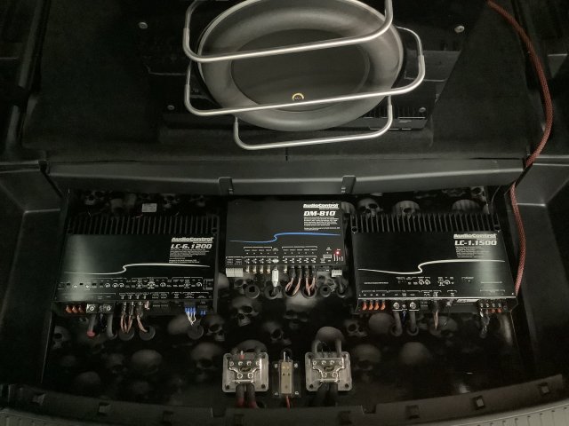

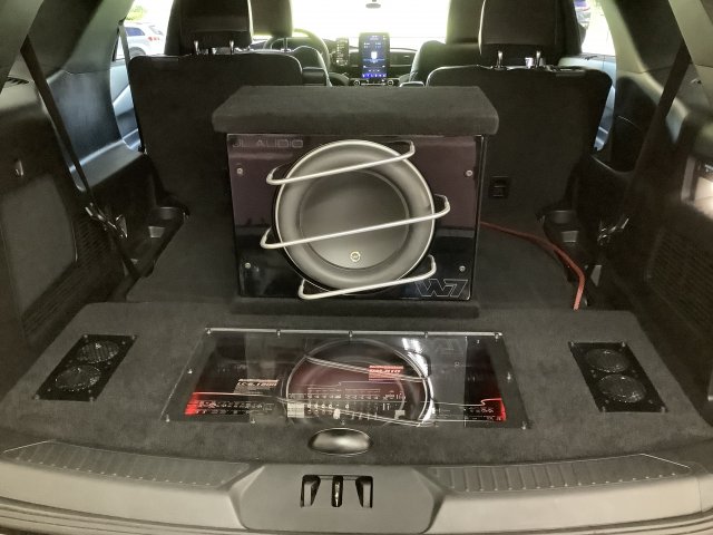

So, after about 2 months of work, I finally finished my system. Components are as follows:
Center Kicker 47KSC3504
Front Kicker 47KSS6704
Rear Kicker 47KSS6704
Factory Subwoofer Kicker CompRT 43CWRT81
Nav-Tv ZEN-A2B / DSP12A-A2B
DSP AudioControl DM-810 with AC-BT24 Bluetooth Programmer
Amplifier for factory speaker locations AudioControl LC-6.1200
Subwoofer amplifier AudioControl LC-1.1500
Subwoofer JL Audio CLS113RG-W7AE
A whole lot of wire, interconnects, and assorted crap.

I know very little about audio these days, but that looks good. Did you achieve the sound you wanted?
mdallas
New England
Fabulous!! very nice job!!

Did you have to make any adjustments for the front and rear kickers to fit. Crutchfield shows they won’t fit and these are the ones I wanted to order
