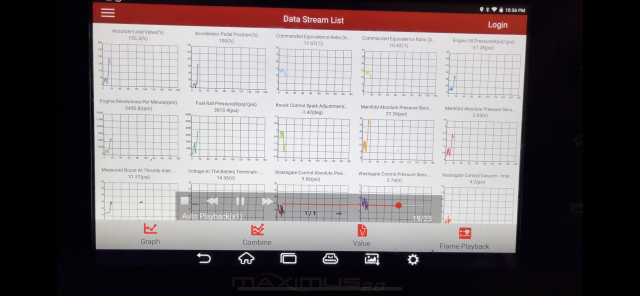

So this is the data log the one to 6100rpm an other one is still to the floor as you see the pedal is still at 100% but dropping rpm so I lifted.
1,506
The fact that a misfire causes the ECU to "lift" is completely normal.
Where are the lambda values that you say are "correct"?

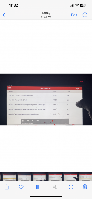

Yes and just tried it again now a same thing. But it keeps showing 30psi

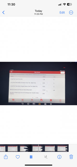

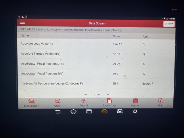

Heres afew pics of freeze frame an log

Tomorrow gonna put pressure on map a see if I’m seeing the same boost pressure as ecu.

What does the map read with the key on and engine off? Will it misfire if you put it in tow/haul mode?

I didn’t see your pm until now. I’ve looked at the data posted and nothing really jumps out. The manifold absolute pressure is local baro plus boost, so you’re at about 15psi boost which is close to normal for stock tune. I’m thinking ignition timing, including any knock retard should be looked at as well.
Haven’t tried tow haul mode an it’s showing .5-.8 idle for volts
