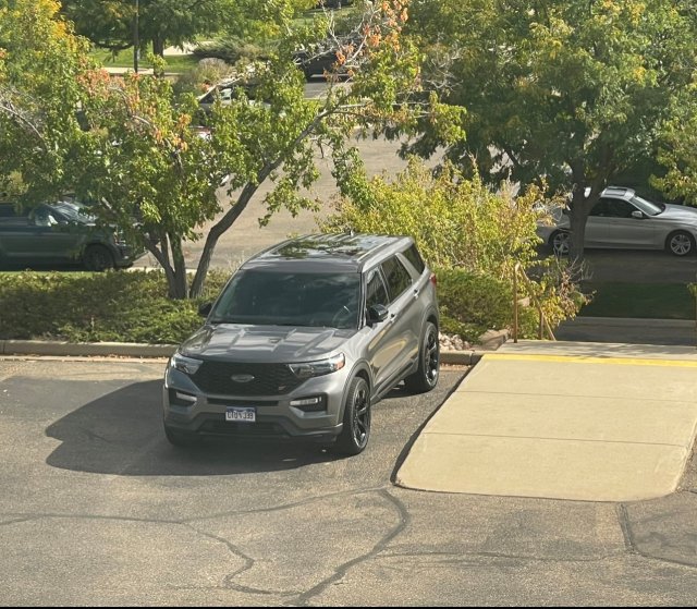

Tried to have 285/45R-21 Vredestein Quatrac Pros installed today at Big O and they said they are certain the tires will rub the front struts without spacers. I've had Bora spacers sitting in my garage for 8 months now, so I guess it's finally time to install them.

Installed my spacers and 285/45R-21 Vredestein Quatrac Pros and it looks so much better than the factory setup, IMO. Ready for this Colorado winter. Need to install springs soon.
