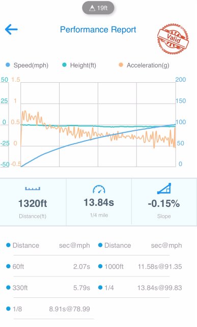

Welp, I installed like the instructions said and realized by the way you installed it that it could not actually DO anything. The hardware/software exist for this type of device to actually alter the PCM to increase power, BUT this doodad is indeed snake oil of the worst sort. The dude(?) claims to be a veteran trying to make it. That part is probably true, but the whole thing is a pure scam. I was really hoping it would be legit and gave it the full opportunity to meet even a little bit of the claim(s), but nope, junk.
I ran the ExpST on the same road each direction same process as before device installation. It had about 5 gallons more fuel in it, but fresh fuel after the required driving distance. Here are the Dragy before/after results as actual PROOF that it isn't worth the plastic it's made of. The ExpST ran a tenth slower with the device installed vs without. I'll call it a wash as the trap speed was essentially the same. The extra ~50lbs of fuel weight accounts for the tenth difference. Oh well...

Is my ignorance still "palpable"? LOL
But, respect for a post that'll save somebody money.
