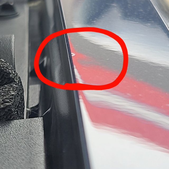

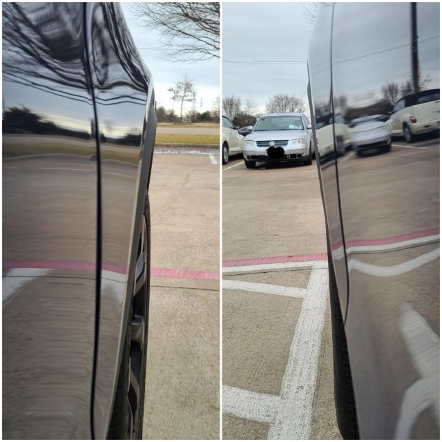

Had a few interior cosmetic issues, one resolved and the other scheduled to be resolved; both require replacement of one driver door panel (scratch) and a rear upper interior panel (another scratch). Also noticed a dent in the hood that has already been resolved.

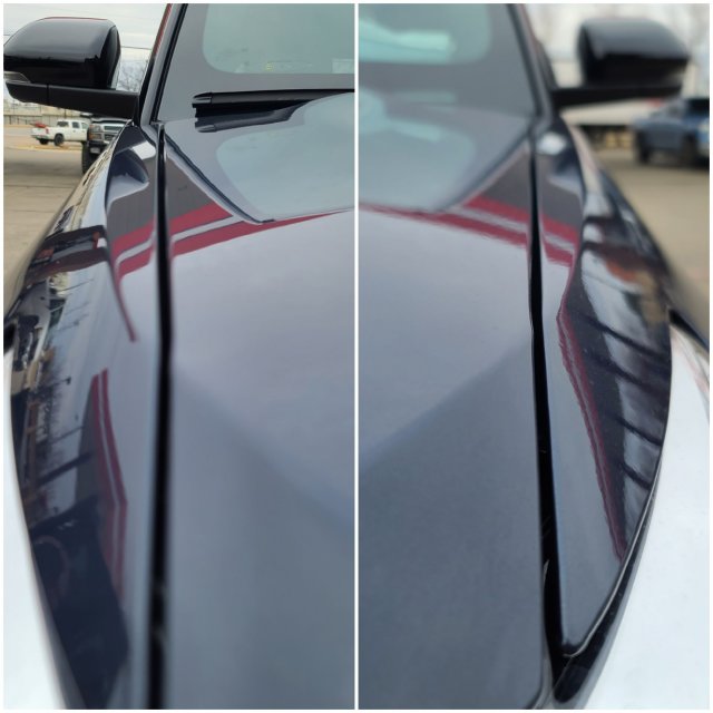

Yesterday, as I was detailing the car, I noticed another dent on the driver fender (pictured) where the fender and hood line up and also noticed the hood and fender on the passenger do not line up like they should (also pictured).
This level of quality, or lack thereof is concerning and aggravating for a $55k+ vehicle...

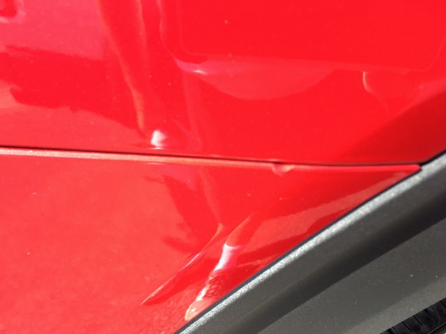

Inspected mine at delivery. It was trailered in from St. Louis on a dealer trade. The rear bumper piece had to have something fall against it before it was installed at the factory unless a machine did it during installation. You would think it would have been called out on a QC inspection. It almost looks like the paint was wet when it happened. It's on the pass rear side behind the rear passenger wheel opening and I never see it except when I apply ceramic wax. I could have gotten it fixed if I wanted. My salesman and I thought since I trade so often that I might as well leave it. Now with all the modifications done to this vehicle I'll probably keep it a lot longer than I normally would. They would have to repaint the entire rear bumper just to correct that small dent. I may still get it done someday.

Those aren't necessarily factory defects, though they could be. There is a lot of damage that occurs during transport as well, and is more likely to occur there. But there are some factory escapes that happen as well. I am having a hard time seeing what the issues are in the photos. The first photo appears to be a small circular scratch on the left (driver's side) fender? The second photo I cannot find the issue, and the third appears to maybe be a scuff mark on the drivers side door?
I used to address all of the paint related warranty claims for one of the Ford plants, so I have a little experience with this.

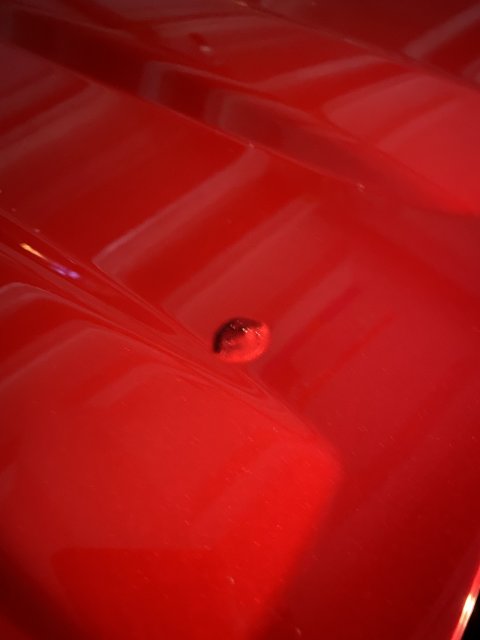

the only thing I’ve found is this paint blob on the top of the roof.

That looks more like an "ecoat drip" but without cutting into it, it's hard to tell (and could just was well be a glob of paint). Either way you have a clear case of paint warranty defect there, regardless of root cause.

I'm willing to bet it looks much bigger in the photo than it actually is. If I had to guess it's about a half a dime size. Most people don't climb up high enough on a vehicle to see the roof of an SUV when buying a vehicle. This is absolutely a factory "escape", but even with me knowing very well about all of these types of defects, even I do not look for them.

To be honest, I did look over the vehicle, but I neglected to check the actual roof. I haven’t had a chance to take it in yet as we just got back from our drive from Las Vegas (from east coast). I’m in no rush to get it looked at. But I will bring it to their attention when I make it to a dealership.

Many of the hoods on the Explorers are off just a bit. One of the first things I noticed. Luckily mine is just about right, otherwise it would bother the heck out of me, since I wash it every week.

As a painter, you’d be crazy to get that little blob fixed! Just leave it. I generally work on high end cars (Caddy’s, Jags, LR, Porsche etc. And people get tri-stage paints that are impossible to match and we have to blend everything. You have a door paint defect and end up painting the entire side of the car lol. There’s no ways around it. It sucks!!! Who in their right mine wants to have that much work done on a Brand new vehicle?
