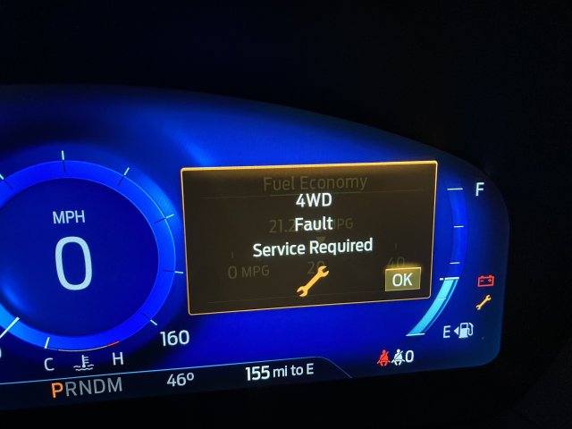

Any ideas what the problem could be for this light to come on?

From what I have learned, definitely try just turning the car off and turn it back on after some time has passed. That’s my recommendation. I’m sure someone here will be able to shed more light on it but that would be my first thing to try. I’ve had faults like that one time regarding backup brake assist and it went away on its own.

I went into Forscan to clear it and it clears then comes right back on again.

Did Forscan give you a DTC? Or have a Scan tool that will? If so you could post it here or google it. That might help. If not you may need to take it in for service.

Went into the DTC and cleared all codes.

I seen that you had cleared the code but it came back. A DTC should have a number such as this U0102. I don't know if Forscan gives a DTC number or not. The right scan tool will. That number can give some direction on what the issue might be.

I did see a code, did not write it down. I will hook it up again Tomorrow and write it down.

Same light is on for me after attempting to change tire size after new wheels and tires. Forscan says its a configuration error for me.

Same-P160A is the code configuration error. How do I fix it?

Had the dealership clear it for me and hasn't came back since after noticing it a few times. Said it was a software update error of sorts and nothing to be concerned of.

Before I made changes to the wheel size on Forscan, I saved a copy of the original program. Does anyone know how to install the saved program?
