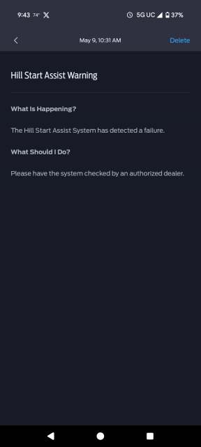

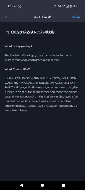

Hello All -- Just looking for recommendations and any insight on next steps.
Y2020 Ford Explorer ST showing either both or ZERO of the following depending on start-up.
If start vehicle and planets in alignment, we see both the errors below displayed on dash - and received by FORD app.
Often if you stop vehicle, re-start, the errors are not present. To be clear: it's either ALL (both errors) or NOTHING.
If you search both errors individually on interwebs, there appear to be separate fixes for each.
However, since each can be "cleared" by restart of vehicle, I suspect the issue more related to electrical and/or ECM of vehicle than individual sensors, etc.
Any sort of insight and recommendations would be appreciated.
Thx

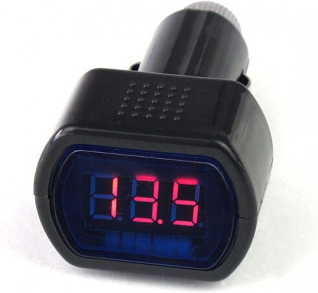

I would scan for trouble codes, and check my battery. You can plug a volt meter into you lighter outlet to see if the battery voltage drops too low when you start.
