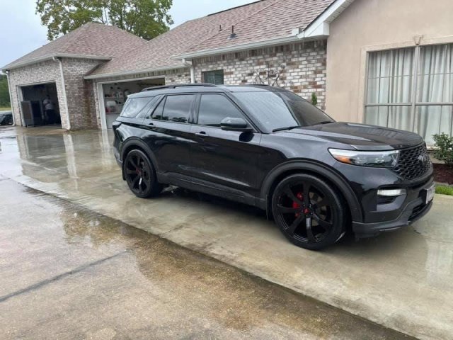

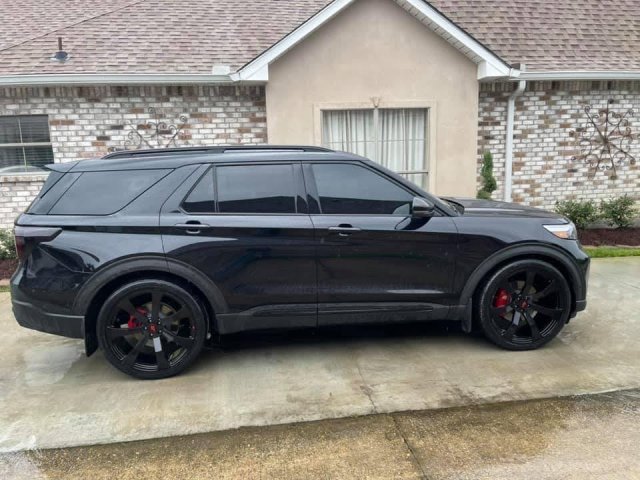

24 by 10 niche with 35mm offset
285/30/24 nitto 420s tires
the ride is actually a bit better with the nittos I suspect because they are soft hahaha I will keep you guys posted on how long they last
There wasn’t a lot of options in a 30 profile View attachment 740 View attachment 740 View attachment 741

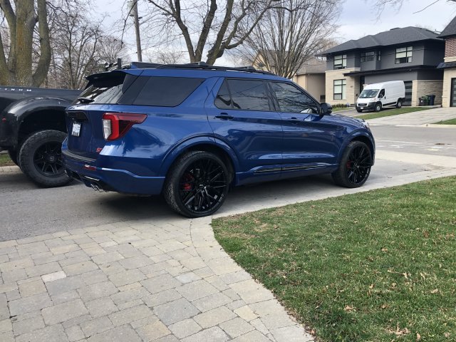

I just got these wheels and went with 285/35/24 Toyo ST3’s. No rubbing at stock height. Will report back when I get my H&R Springs in.
F81AD78E-5DFC-49E7-A4B8-BBC67A083FA3.jpeg FA1215A3-030C-420B-95BD-7E49CED351DF.jpeg 46727B10-944A-4DE9-AC0D-6AEFFFE8D027.jpeg

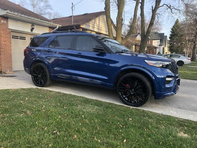

What offset on your wheels?
Same as mrruff, 24x10 +35.
There is no way in hell I would want anything further out than that. I personally think the 22x10.5 +30 looks too aggressive and pokes out too far.

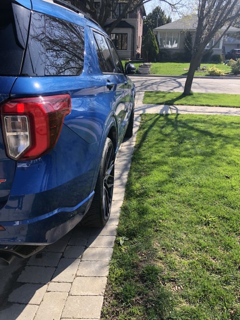

Damn. That is a tight fit.

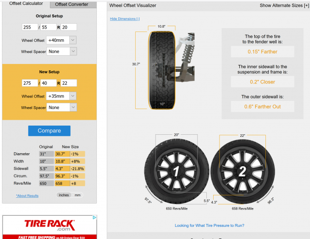

That's because he went with to tall of a tire. He should have gotten a 285/30/24 and he would be right at 30.7" the same overall diameter as the stock 21's.
Why the shit would I do that when this fits and doesn’t rub AT ALL? No chance I’m sacrificing sidewall and ride quality to stay at stock diameter on 24’s. Once I’m lowered they will also fill the wheel wells much better than a 30 profile tire does.

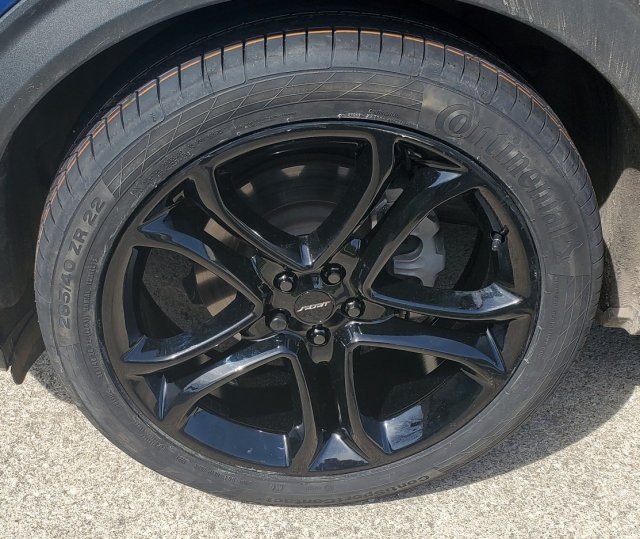

I don't care what you do, I was just explaining why you were so close to the shock.
BTW my ST came with the stock 20's with 255/55/20's which are a 31" tire so I went with a 285/40/22 on 22x9's and they are also a 31" tire.

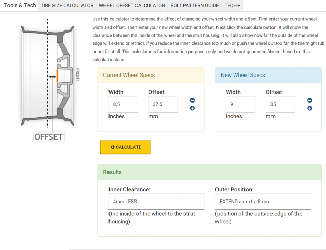

Has anyone run with an offset closer +23 to +25? Looking at a 10" rim with 295s
