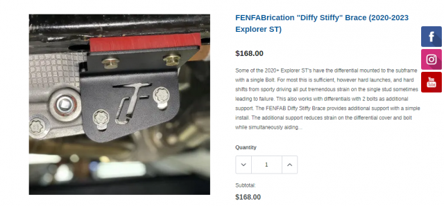

Cheapest option: https://hellhorseperformance.com/products/fenfabrication-diffy-stiffy-brace-2020-2023-explorer-st

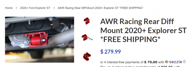

Next best: https://whoosh-motorsports.myshopif...s/awr-racing-rear-diff-mount-2020-explorer-st
I have this one, I think it's the best compromise for the price.

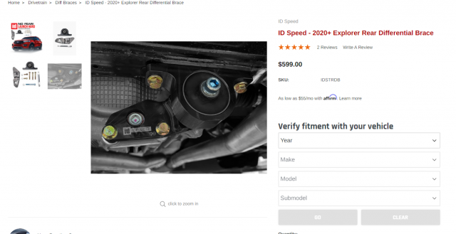

Expensive: https://idspeedshop.com/id-speed-2020-explorer-st-rear-diff-brace/
Probably the most effective.

I hate to seem to pick on a vendor but....the Diffy Stiffy is not a viable alternative. Buy the AWR or the ID Speed depending on your budget.
