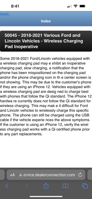

I just recently purchased an iPhone 13 and it charges for a few minutes then I get a message stating charging terminated due to misalignment. I don’t have a case on it and my iPhone 11 even with a case never had a problem. Took it to Ford and they told me there is no issue. Does anyone have any idea what to do. There are no coins or anything in there

I tried to click on the link but it won’t pull up. I took my truck to Ford yesterday and they said there is no update and it’s the phones fault. I had the iPhone 11 and it charged no problem the iPhone 13 pro nothing but error messages

It’s obviously the new phone if previous versions worked fine…
Rotate the phone and try it again. There may be some proximity issues if Apple moved the inductive pad inside the phone. My 12 and wife’s 10 work fine.

My IPhone 13 behaves the same also, very slow to charge, gets very warm, error messages. I have a 2020 explorer and 2019 edge, same thing in both vehicles

My wife's iPhone 12 charges pretty slowly, and gets the Misaligned error message often. She does have a thicker case on it, and I think the ridge around the camera causes it. My Galaxy S9 has no issues, never got the error no matter how I drop it against the pad, charges fast, and doesn't get any warmer than my wireless charger at home. Seems like an Apple issue.
