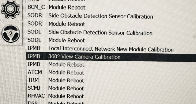

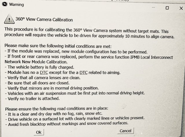

Good news! Forscan 2.3.66 has the service procedure to calibrate the 360 degree camera system.
Sorry for the bad pics but don't know the screenshot keystrokes for windows on a Mac.

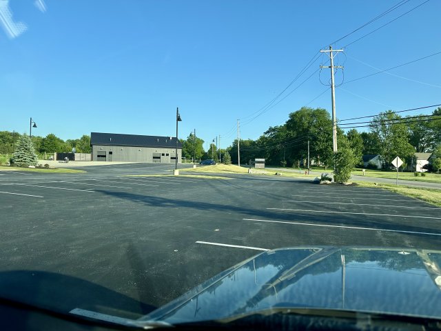

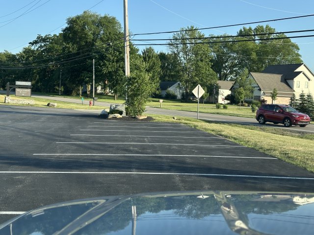

Just go to a well marked empty parking lot with clear lines. You do not need a long continuous length but it helps to have an adjacent marked area to turn into to continue the data collection. Here is where I did mine:

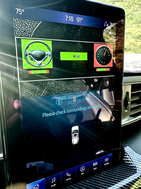

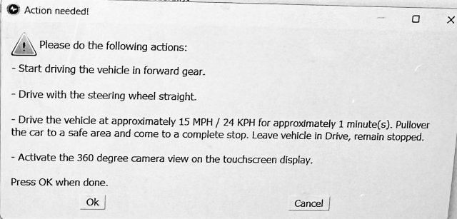

Read the following screens and follow them closely:

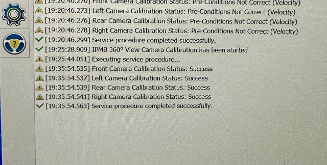

In a nutshell, activate the camera button on the dash once in drive. Drive very slowly. The data collection will only work with steering wheel straight and speed slow. You can turn around to an adjacent area to resume the data collection. If you drive too fast, the graphic will disappear--slow down and hit the camera button again and resume. The middle gauge will say 100% once you have enough data. At that point put your foot on the brake but keep it in drive. The graohic in the below pic should stay on screen. Click OK on the laptop and the processing will proceed. It takes a good 10 minutes or so, so be patient. Took me a couple of tries when i failed to follow the directions carefully.
Thanks to the Forscan people for making this happen for us Explorer folks. Previously, the F150 could do it on Forscan but we could not.
