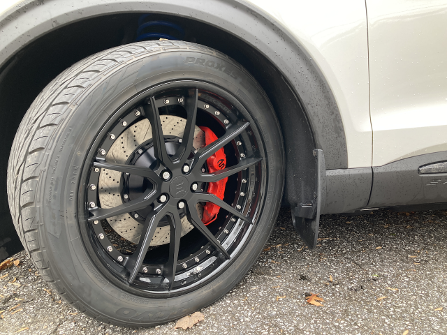

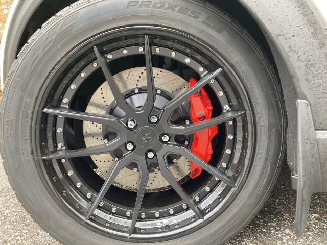

Hey @Mr.Clark ... so this question has been answered a bunch, but here you go. The below are pics of a +30mm offset setup. It DOES rub, just barely with Toyo Proxes ST III tires. After 25k miles on this wheel/tire setup, I am just starting to rub a little hole through the felt fender liner. It only rubs at full lock and only rubs on the passenger side--so tire clearance is going to be obviously very variable. I have purchased a replacement liner and will swap it out once I think it needs to be. The outer part of the tire is what rubs, but you CANNOT reduce offset to pull the wheel closer inwards as then the tire will rub against the shock strut tower. I can literally only slip a piece of cardboard between the tire and the spring perch. Would I repeat this setup again? 100% yes. 315/35r22 tire pricing is full blown stupid and i like the look of a more filled out wheel well.
