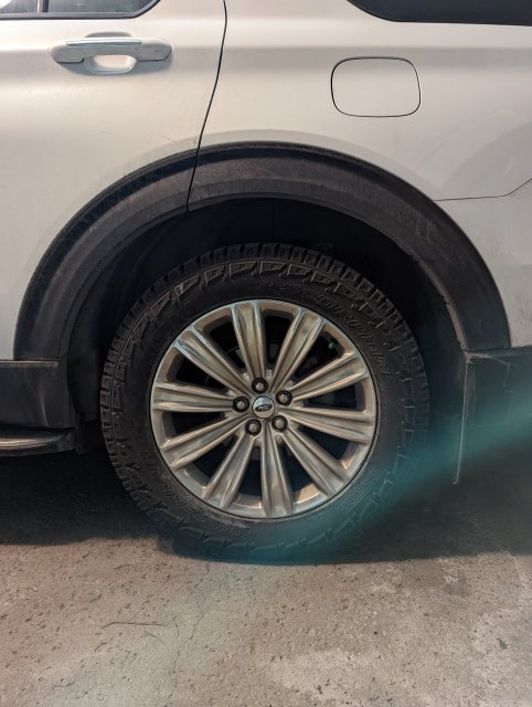

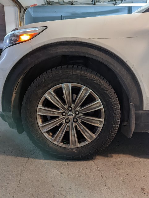

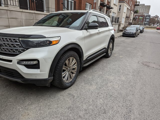

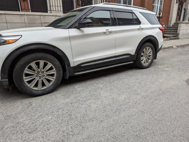

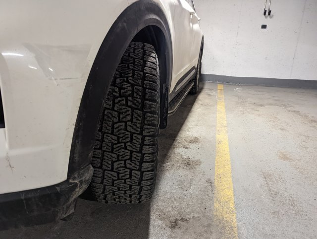

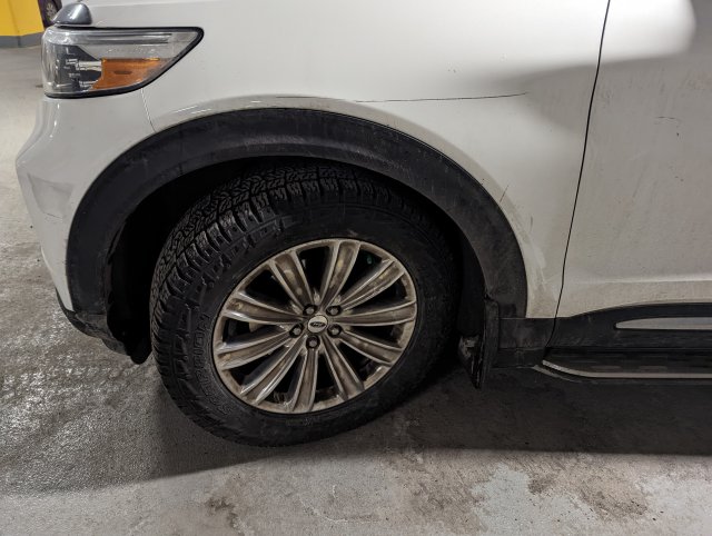

Not an Explorer ST....
But a 2020 Ford Explorer Limited...
P275/55/20. On OEM 20x8 inch wheels.
I decided on this tire size because it's a very widely available and popular tire size.
Tire size can generally be found on F150, Ram, Silverado...
Fits without rubbing, no lift, no spacers. Completely stock.
They don't look too oversized. Tires are Pirelli Scorpion all terrain, which are above average for most driving.
