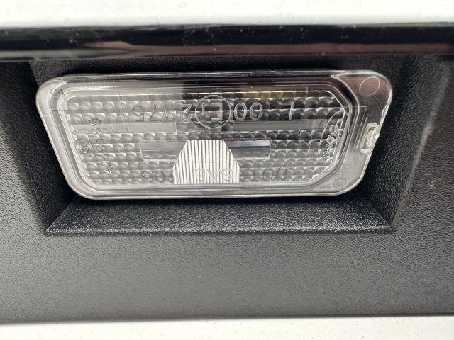

So the 23 lenses are different not just release the tab on the right and they drop down like the older ones.
In the pic I release the tab on the right and that only released that side everything else is still attached and will not release any more pressure I put and feels like it’s gonna snap. Does anyone know the trick for these ?

so when I push the clip in on the right side and it releases I than try to pull down the rest of the lens and it will not come down I put enough pressure on it where it felt like the lens was going to snap. There is something else holding the lens up but I do not see any other clips. I tried on both lenses and it’s the same. I know the older models it was just the clip on the right and it came down.

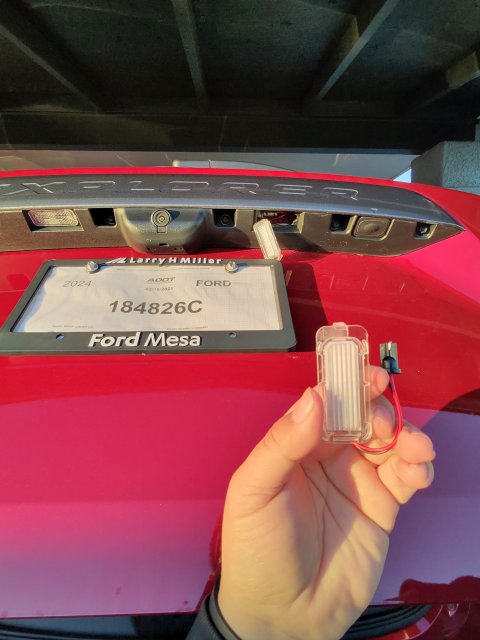

Welcome to the forum. If you look at the pic in post #2, you will see there is a bulge on the opposite side of the release. Once you push in the tab and release it, you have to pull that side all the way out and the other side is free.

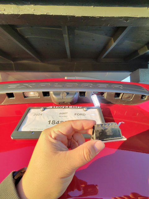

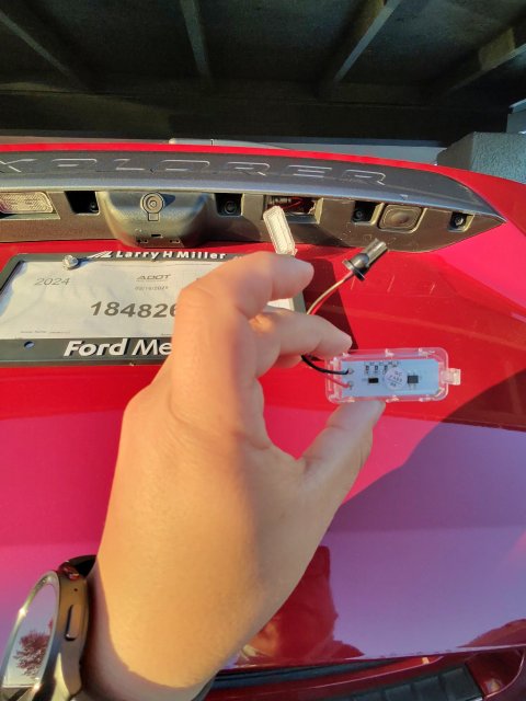

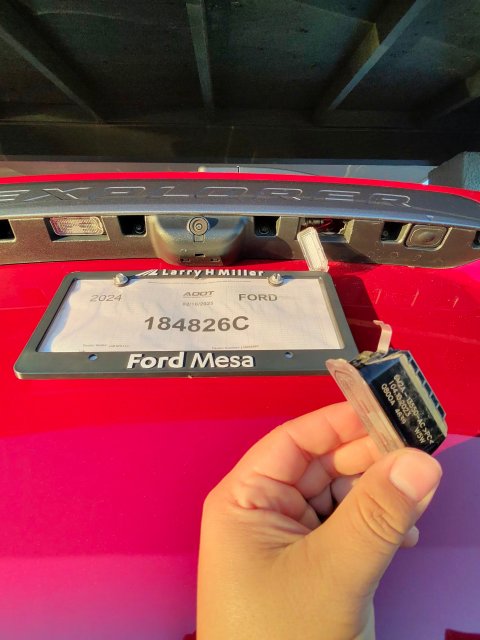

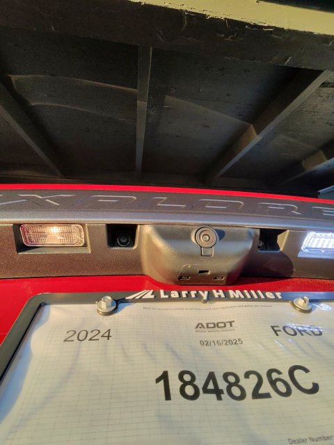

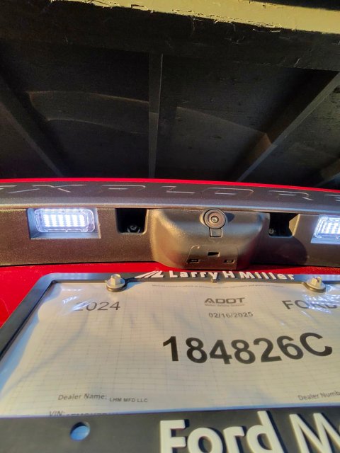

Thank you, appreciate it, got it done, here's a few pictures i took. For anyone looking to do this, i just used a flat head screwdriver. Ill leave a link to the ones I purchased. They light up so nice .
Generic Leesoot 2 Pcs Error Free Xenon White LED License Plate Light Compatible with 2009-2018 Ford Explorer Fiesta Fusion Escape Focus Mondeo Lincoln MKC Rear License Tag Lights Lamp BB5Z-13550-A https://a.co/d/7wZo65a
Wisconsin
2024 Ford Explorer ST
Thank you! I was confused myself on why it wasn't coming out. I'm guessing by the pictures you pushed that metal tab up and bent it enough to then slide the light assembly out?
85364
2024 Ford Explorer
Yes, that is exactly what I had to do, I don't know why its designed that way but yes, I had to apply enough pressure to push that metal tab up and bend it enough to slide out.
